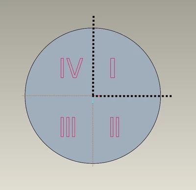

Since your models are similar and presumably symmetric about the standard datum planes, you might consider using two solidify operations to generate the quarter-chunk.  Just select the cutting plane, then the solidify function, then pick the side to cut-away, or accept the "default" with a middle click.
Repeat, and you're done:
If your models have the same starting structure (e.g., 3 datum planes + CSYS), you could just record this into a mapkey.

It is possible to automate this. From your description you will need to apply this to existing parts and also "clock" the cut to get the desired cut away model for STEP export. You would be best served by a method that will auto clock by an incremental angle i.e. for a 90 deg increment you could select quadrant I though IV to be retained as the solid for export. You can make the clocking angle increment variable in a UDF for flexibility. Pro/Program is also an option to automate this process in the context of a single part.
