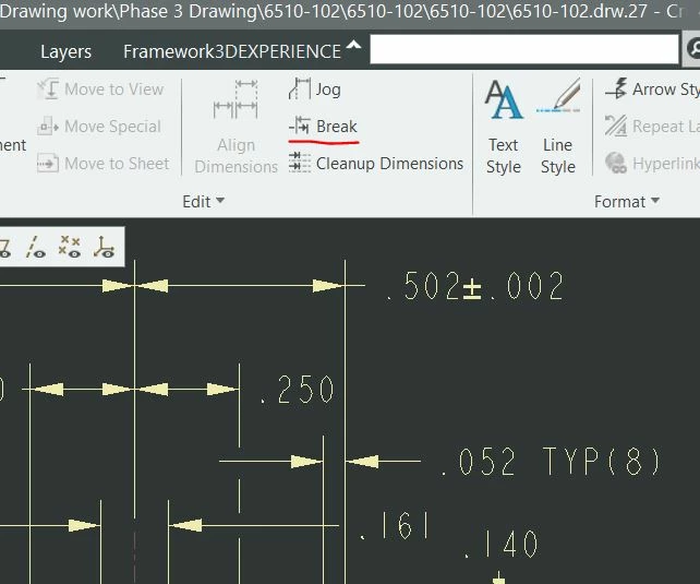

Can we automate line break option in Creo drawing
Hello ,
can we automation line Break option in Creo drawing so that we dont have to do it one by one and there are lot of such dimensions in drawing which are overlapping. If there is a mechanism which can detect overlapping dimensions and provide line beak can save lot of time in drawing

Hi @RR_10658669
As of now, there is no config option to enable Break as default. I am unable to locate any Idea, you may submit a new one.

I don't think there is any automatic line break options.

Patriot_1776
What you're trying to do is incorrect per ASME Y14.5-2009, paragraph 1.7.2.1 and Fig. 1-11.  Extension lines should ONLY break for arrowheads and text.
Chanced upon this three-year-old thread. Perhaps you are looking for the following settings in config.dtl. One can set the following settings. However, breaking around arrow tails…??? I am not sure. need to try.
def_xhatch_break_around_text YES
def_xhatch_break_margin_size 0.200000
dim_text_break_witness_lines YES
