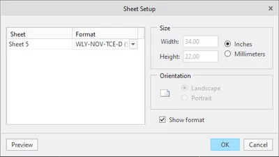

Can we create the color pdf just the shadow view and not the title block?

You can turn off the format in a drawing by going to the sheet setup and unchecking the "show format" and then create your PDF
