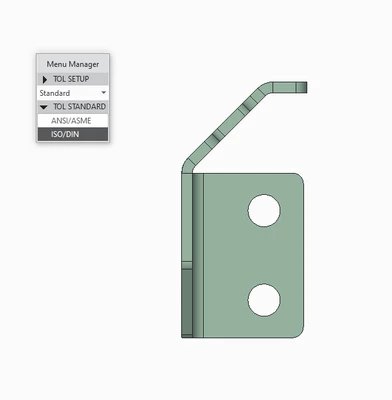

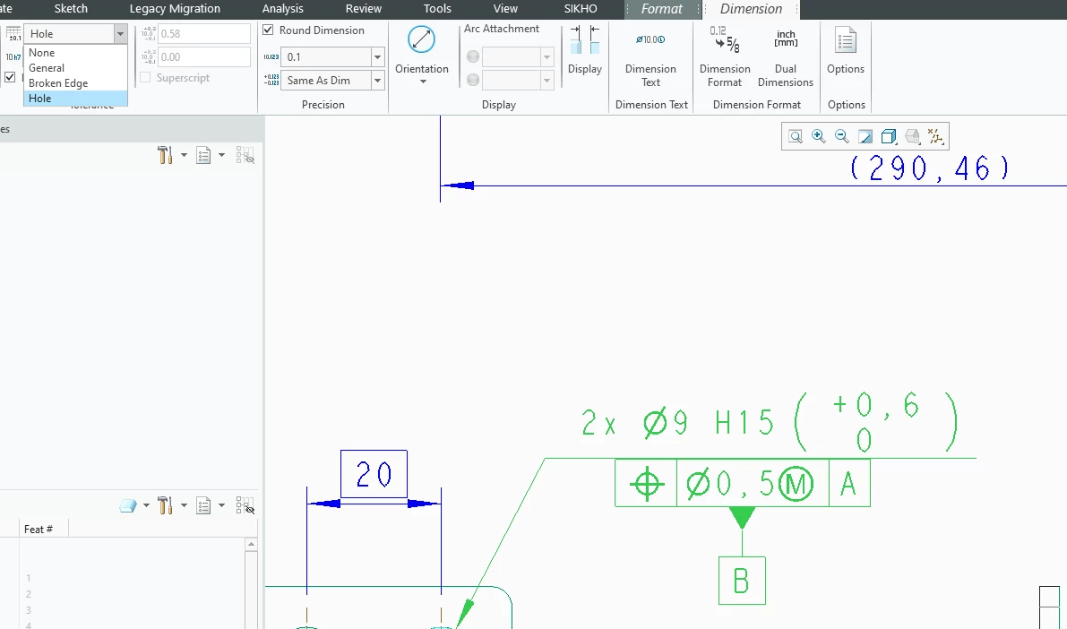

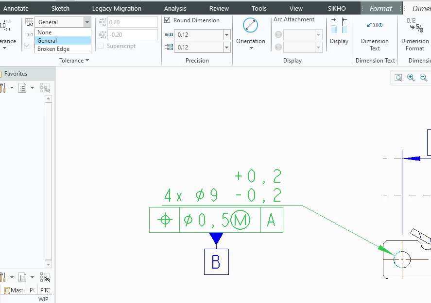

I have problem in my creo version 8. I cannot add H7 tolerances do some drawings. For some I can, for others I just can't see the option to do it.
I tried to change settings of models, add tables with Hole tolerances etc. Nothing seems to work. Does anyone have any ideas?
I am attaching 2 examples - one is a drawing where it works, other where it does not.
Ok, was able to solve this.
It seems that the steps from your first post need to be done, but for both model and the drawing. Then it works. Only model is not enough. Thank you!

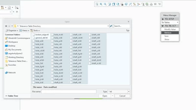

You need to add the tolerance look up tables to your Creo model. They are not loaded by default.
Follow the instructions here and report back:
Thank you, I already tried that. It does not work. I have just repeated all of those steps. Attaching snips.

That looks like a sheet metal part in your picture. Is this an issue in only sheet metal parts?
