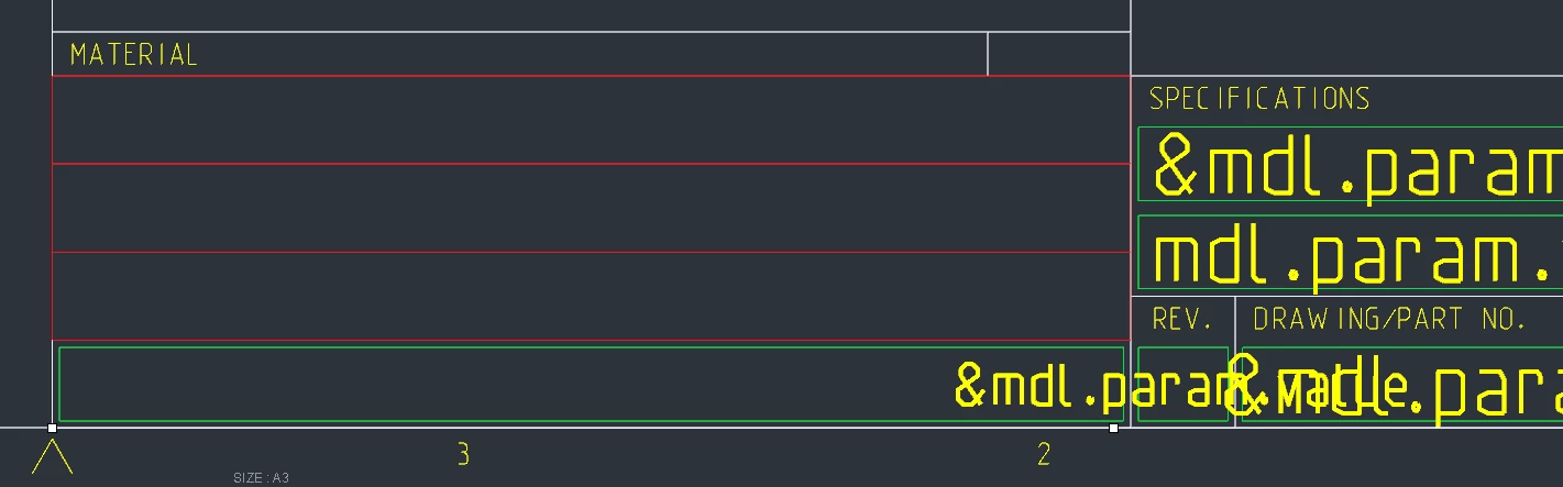

I'm a Creo Parametric 4.0 user. I'm updating the drawing templates for my company and I would like to add repeat regions in a table. In the repeat regions, I intend to display 3D-model parameter.

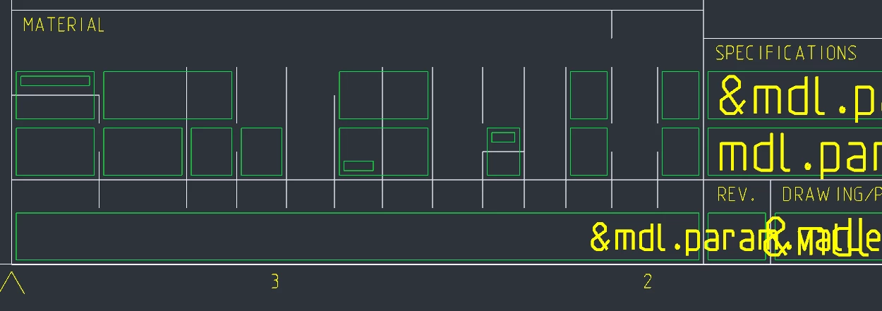

However, for some reason, I'm not able to add repeat regions in a couple of table cells and an error message appears. In most cells it works perfectly fine, but in some cells it really bugs out. See attached pictures. If I unmerge the large cells, I'm able to create smaller, independent regions, But I want the region to be defined in large merged cells.
The error message doesn't tell why it couldn't create the repeat region, so I need your advice. How can I resolve this issue?

Aug 25, 2023 7:41 AM UTC
I've never tried to do a repeat region in merged cells. Have you done this in merged cells before? I wouldn't be surprised if this wasn't possible. One workaround could be to merge all of the rows together to create a "hole" in the table, then add a new table there with three simple rows and add the repeat region there.

Aug 25, 2023 8:56 AM UTC
maybe instead of merging cells you can hide inner vertical table lines. Select whole table, apply Line Display command and click vertical lines in table.

Sep 18, 2023 7:54 AM UTC
Thanks for the support. My work-around was to insert a separate table inside the main table and edit the repeat regions in the separate table instead. That way I got the correct size of the table rows and columns.
Previously I had no issues with repeat regions in merged tables until now.
