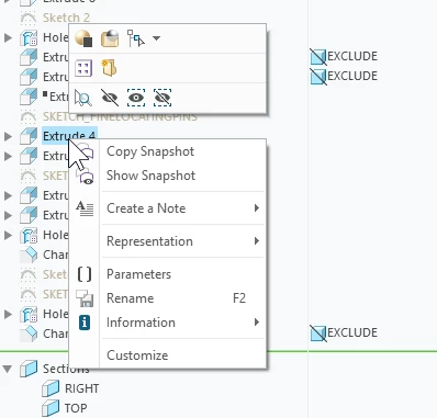

As the title says, when I'm in a Simp Rep of a part, I cannot edit any features or move the insert line / rollback bar. Is this... normal? Surely Creo doesn't only allow features to be edited in the Master Rep, right? That would be a complete mess to work with.
Best answer by MikeBennett
This is correct.  Edit Definition and Insert Here are not available while a Simplified Representation.  Both commands do not appear in the context specific menus and Edit Definition is grayed out along with many other feature operations under Model > Operations.
Dynamic Edit/Edit Dimensions is still available though.

In order to modify the body, the software needs the full geometry loaded. A simplified rep does not load the full body of the model, so the software needs to load it all before making any changes.
