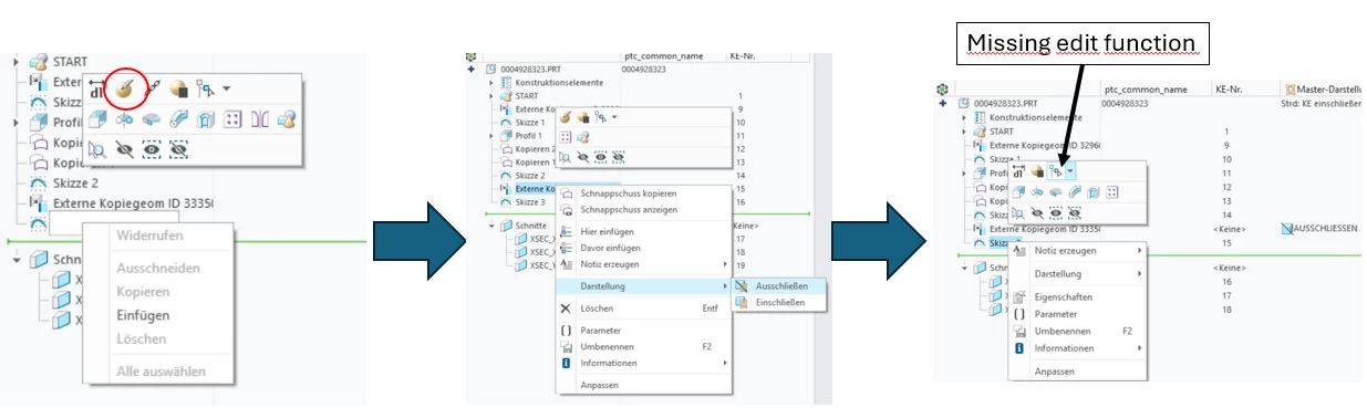

Hello everyone,
after I exclude the display of individual components using the Simplified Representation function, I can no longer edit KEs until I close and reopen the session. How can I, for example, edit sketches again?
It happens when I exclude a Copy-Geom.
Q1: No.
Q2: No.
Q3: I can, but I found the problem.

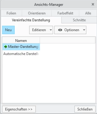

I can edit sketches or extrusions after changing the Simplified REP to Master.

Q1: Can you edit definition of Skizze 1 and Skizze 2?
Q2: Is Skizze 3 dependent on Externe Kopiegeom?
Q3: Can you upload your model?
Q1: No.
Q2: No.
