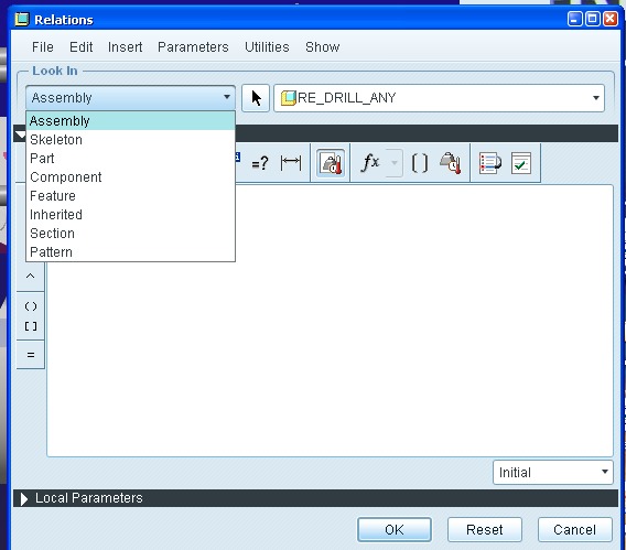

Did you type the relations in while in sketch mode or after the feature was completed? If so the relations are associated with the sketch. You can edit definition on the extrude and go to tools relations to view any relations associated to the sketch. An alternate way to view relations associated with the sketch is to select the pull down menu on the relations dialog box and selecting section.
Hope this helps,
-Greg
February 7, 2011
Hey Greg,
That drop-down menu escaped my attention. Shortly after I posted the discussion I looked at it and was able to reveal the lost relation by selecting 'feature', which can be seen in your image. My relation was created to control the thickness of an extrusion and can be found by displaying 'feature' relations. However, thank you for your tip Greg--I did not know that I could view sketcher realtions without having to enter sketcher mode.
