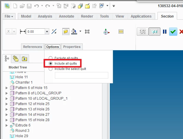

I do not know how and why this is happening. I have M080 running. I cannot hide threads lines and "hidden line removal for quilt" is grayed out.

Frank, I just got off the phone with PTC and the setting I had to change was "show_quilts_in_total_xsecs YES" in drawing properties. I also included your setting as well under conffig.pro. Just in case. You never know with Creo ...
One more thing. They told me if cross section is made without option "Include all qults" under Options tab, option "hidden line removal for quilts" will be grayed out as it was in my previous post.

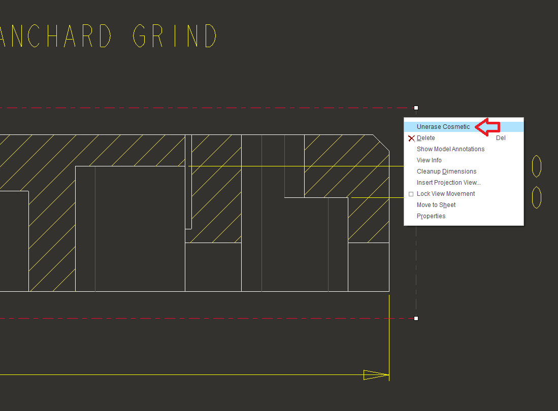

HOLD ON EVERYONE!
Actually, just both of us, Frank.

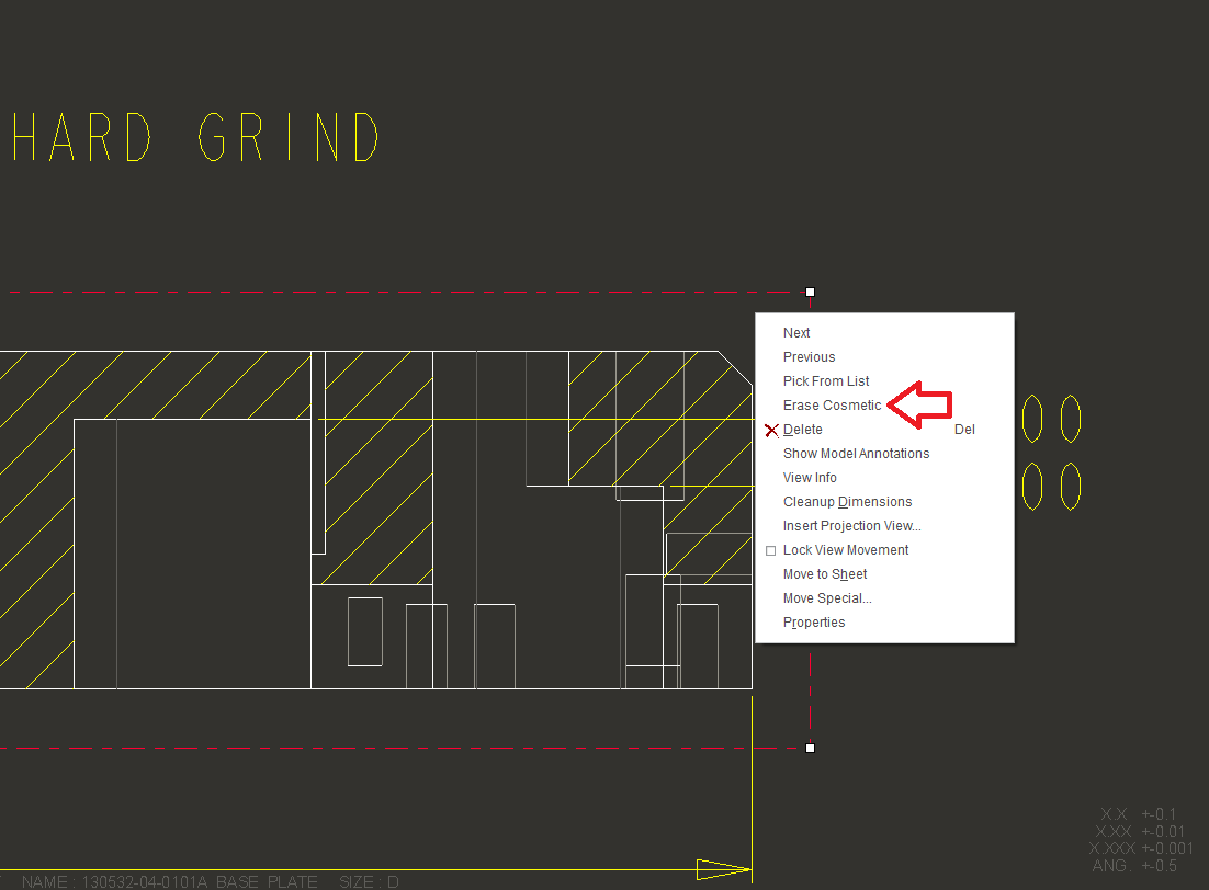

Forget what I wrote in previous posts. I found out this by pure "click" mistake. None of those previous settings work, but this one works for sure:click.png
October 31, 2013
Actually, this just removes cosmetics on every hole. BLAH! Still looking.

After changing "hlr_for_quilts yes" did you redo the section? (change to No Section, apply, then pick the section again.).
October 31, 2013
There is a BUG in Creo when working with cross sections and "LOCAL" option is selected. Everyhing works fine with cross section option "FULL". I guess, PTC does not have a way to disable this BUG as an option .
