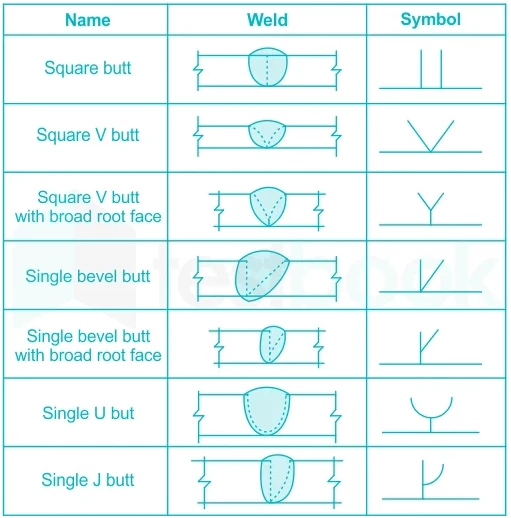

Hi Folks,
I can't find the butt weld option in the welding application ribbon. Any idea where this would be?
Thank you.

Which version would you like.
.These can all be found in the Weld wizard.

I am trying to create a square butt weld. However, I just noticed that the weld wizard does not appear in the ribbon for a .prt database. Other weld options are available, but not the wizard. I was trying to simplify the modeling using a .prt instead of .asm. Do you think there is a configuration option to add the weld wizard to a .prt database? Thank you.

A square butt is one of the groove welds.
