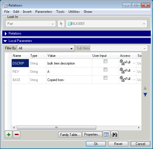

Recently created bulk items (like the blk0001.prt in the picture above) I can open.
as expected I see the this window:
When assembling this bulk item I do not need to confirm its reuse, it just assembles
