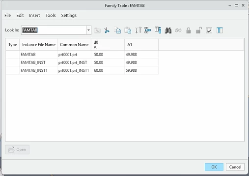

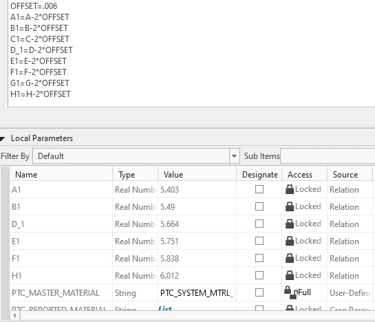

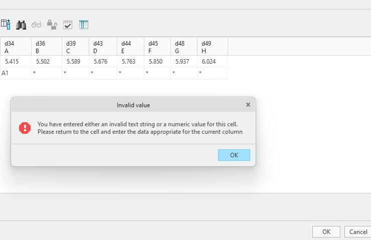

i am struggling to add the new dim Parameter in another instance in the family table. Apparently, it doesnt like parameter names.  i thought i could rename the original dim (A, B,..so on), add an offset, create new dim as a parameter,
error "you have entered an invalid text string or a numeric value"
apparently, it needs to be a number. what will be another workaround?  Ultimately, i want use these new parameter (A1, B1, C1, D_1, E1, F1. G1, H1) in a drawing table.
It seems that i have to convert the string into a number?

What you are trying to achieve is not possible due to invalid value types.
Explanation:
For dimension d34 (A), the value type is real (this applies to the entire column), and for A1 it is a string type (A1 in this case is not treated as a parameter used in the relation, but as an actual value).
These two types are not compatible with each other.
As the dialog says, you must use a value of the same type!

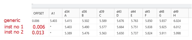

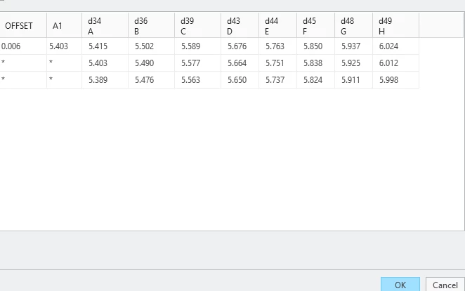

But i already did that but A1 is assigned to the 1st instance instead of the second.  I want to keep the 1st instance at a zero offset (which is the original A, B,,, dimensions). The second instance at the 0.006 offset with the new A1, B1 the third instance at a 0.013 offset and so on..... Right now, i am typing the calculated new dimension in the table instead of the using the relation based dimension
i also want to add the new parameters in a drawing table so the threads can be machined at the different offsets from the shoulder (left or right)
Dec 5, 2025 1:04 PM UTC
please pack you model into zip file and upload this zip file. I need to work with your model to understand you "situation".
Note: If every instance has its own OFFSET value then you have to put it into appropriate cell. See below.

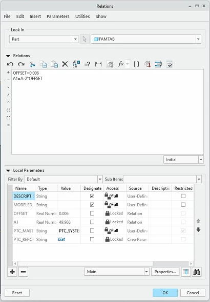

I've done things like what I presume you are attempting. An approach I think would work well is as follows:
(1) Define a set of parameters that will contain the "nominal" values of a particular instance.
     Anom, Bnom, Cnom,...,Hnom, etc.
(2) Define a parameter for your offset
(3) Define a set of relations that use the nominal values and the offset to set the pertinent dimensions
     A = Anom - 2 * offset
     B = Bnom - 2 * offset
(4) In your family table, for each instance, specify the nominal values and the offset.
