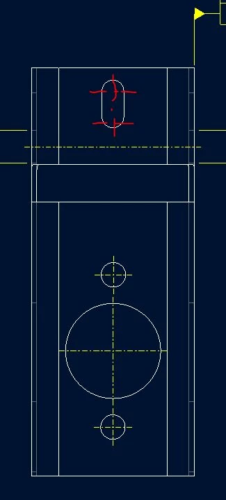

Center line of slot hole
On a sheet metal drawing, there are holes and slot hole. I found that Creo did not recognize the center line or axis of the slot hole. How can I make these center line shown on the drawing or the best way to solve it? Thanks.
psobejkoAnswer
Jul 14, 2016 4:38 PM UTC
Add two points (geometry points, not construction points) in the extrude slot feature's sketch where your centers are;  These will turn into datum axes when extruded; then show them on the drawing as needed.
