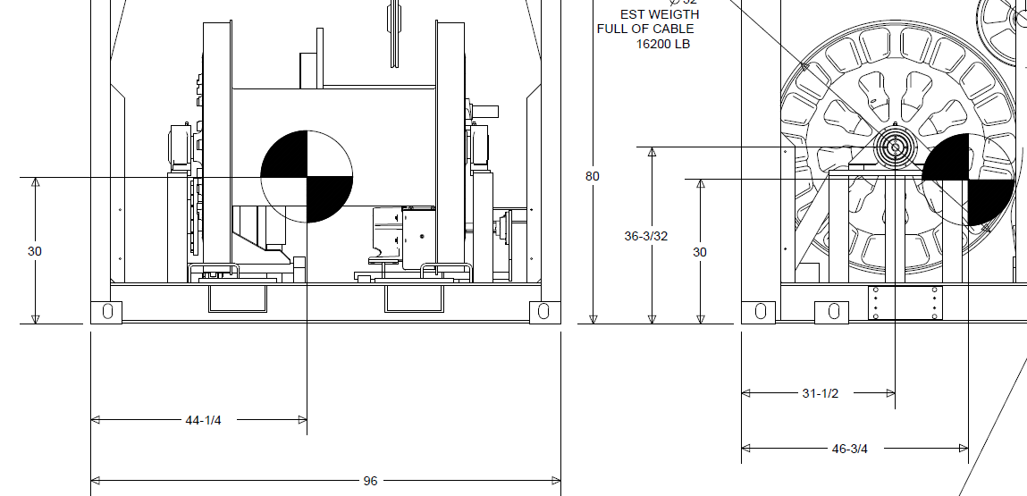

May 26, 2017 10:23 AM UTC
As far as my understanding goes it is necessary to get the BMX extension in order to actually drop a point establishing center of gravity.
In the Mass Properties tab if you have BMX you can save a point.  Otherwise you get the XYZ location but have to manually place a point.
I really think that it shouldn't be necessary to have an almost unrelated extension to place the center of gravity point.
I am hoping that someone else might be able to share an easier way.

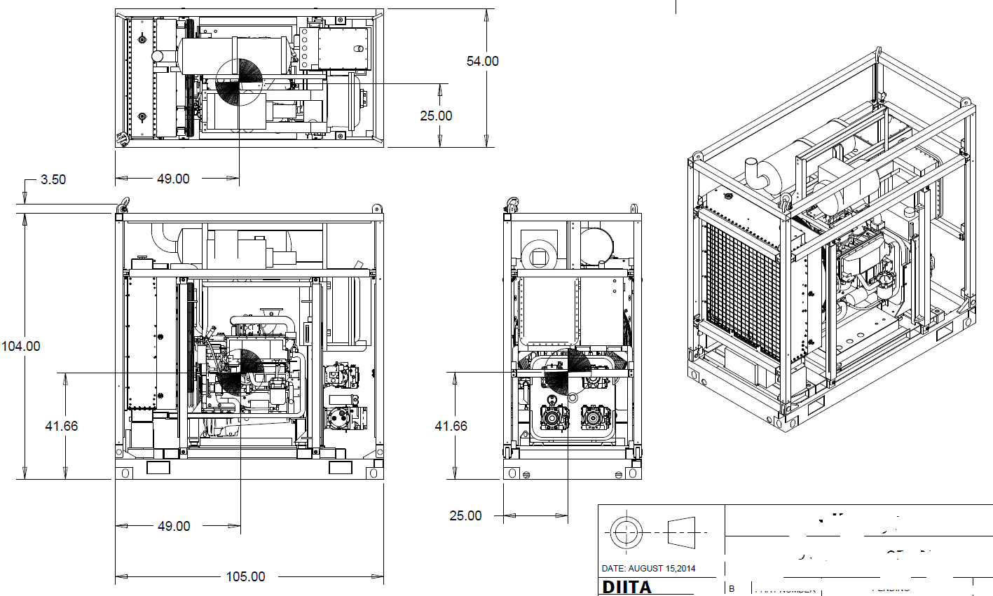

You need to have the Advanced Assembly Extension or some form of the more advanced packages to do this easily.  Having those you can create a feature at the end of your model tree  which will store the CG.  Once stored, in drawing mode you can add a symbol or create geometry in the drawing that is reference to the CG feature.  You can lock it relative to the view and dimension it just like in your picture.

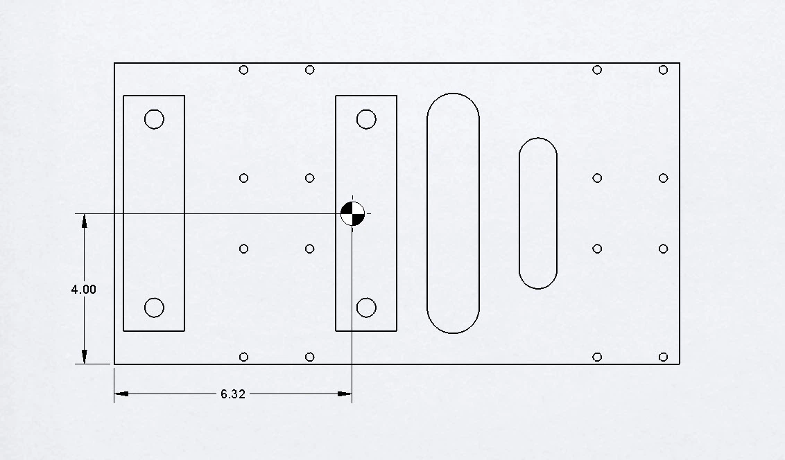

Jun 21, 2017 5:43 PM UTC
ok,
I do what the guys said here but the trick will be the symbol, I tried this way first
as you can see I draw the symbol on top of it, and I locate it close to what the mass properties window say,after all it is just a reference for loading purposes or tipping.
the down side of drawing this way that I have to spend sometime and if I move my views then it becomes a mess, an you can see the lines drawn.
so the way I thought about making it quick and easy is if I do a cross section then I modify the hatch, and I can scale it easily so I just did a shaft with a 1/4 removed and i brought it to my drawing, created the cross section  a place it on top of the CG point created based on the mass analysis, I guess it is easy enough
as you can see it looks solid and better than my fisrt try, I hope it helps
