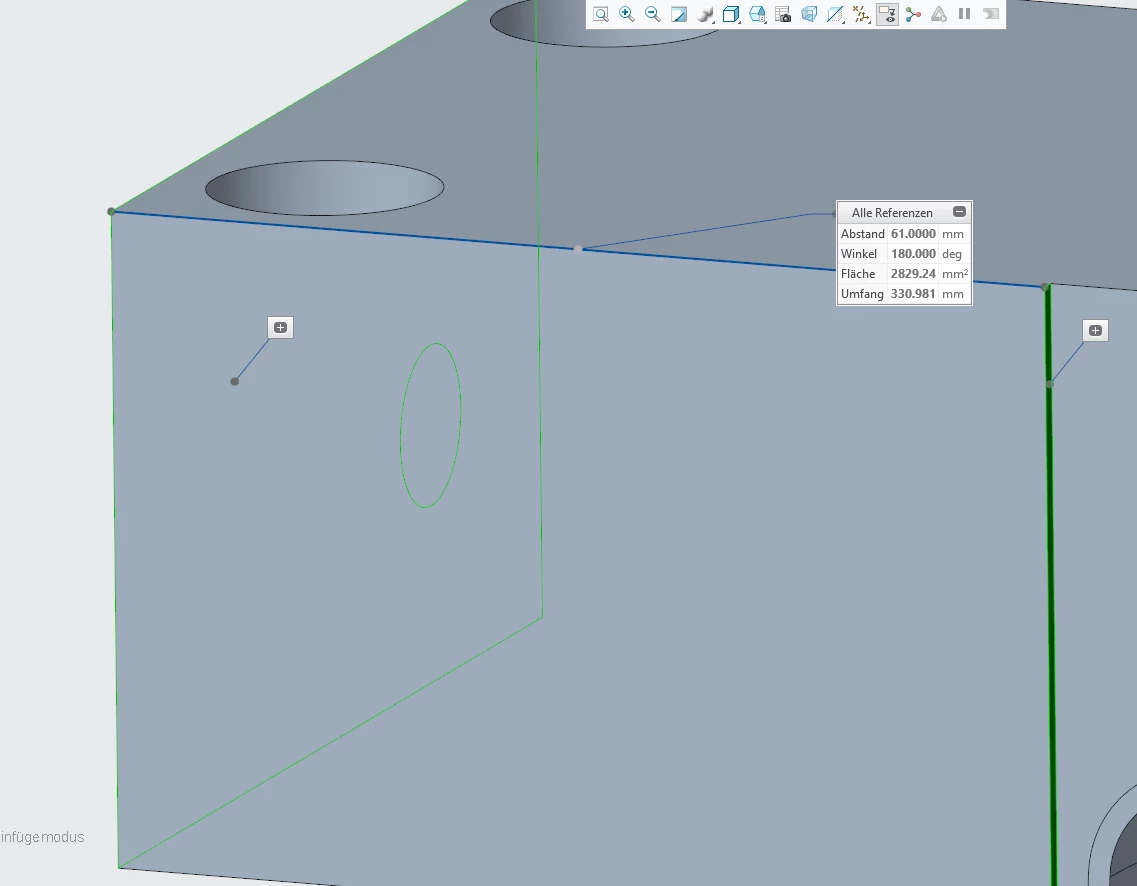

This 1st picture is without chamfer and if I measure it. it shows 61mm (Abstand)

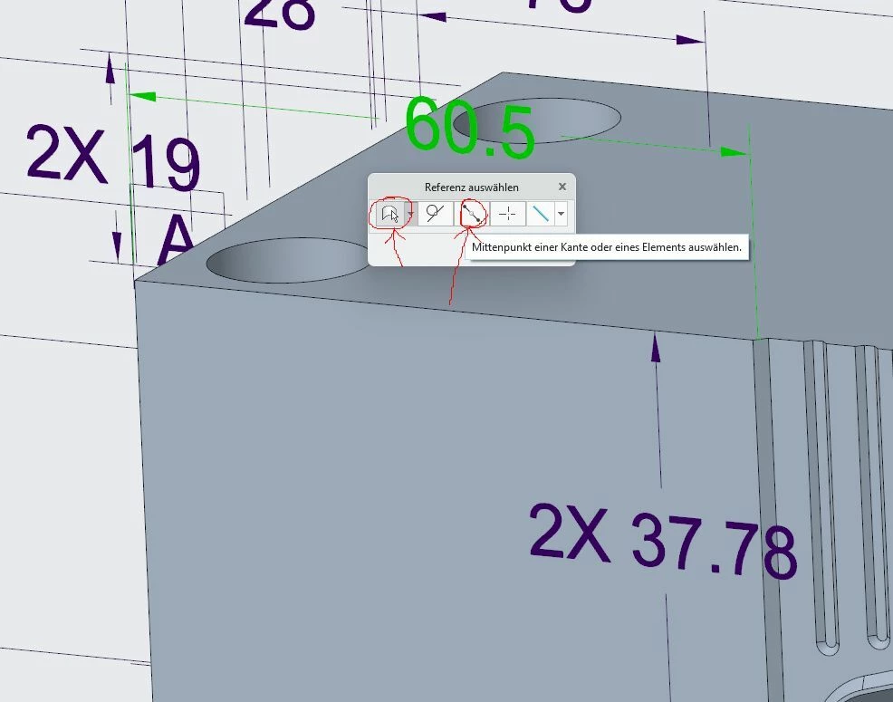

This 2nd picture is after a put chamfer. but when I try to measure from the middle of chamfer to the side surafec it shows 60.5mm.
While I was annotating, I chose the two marked (in red) to measure.
So How do I correctly choose the apex of the chamfer?
I should be getting 61mm

60.5 is what I would expect for the middle of a 1 mm chamfer.  Select the far endpoint of the chamfer to get 61 mm.
