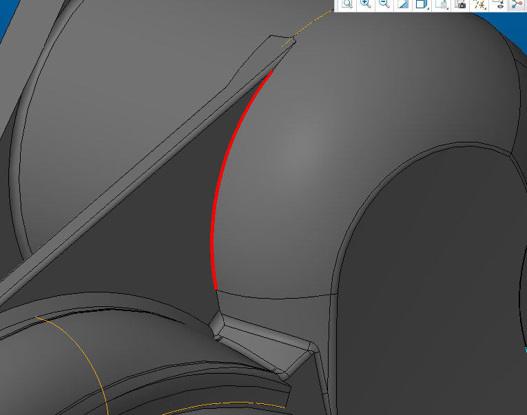

I am trying to create a round or chamfer in the area marked with no success, the rib is just touching a sphere. Any ideas?
The model is attached.

try to reorder the rounds. The smaller rounds on the ribs can be added after the chamfer or the round that you are trying to create.

I still cannot create a chamfer or round at this point. I deleted all the chamfers and rounds and tried a different order but no luck.
Any pointers?

See attached part. I had to edit the Extrude_5 and re-add the rounds around...
