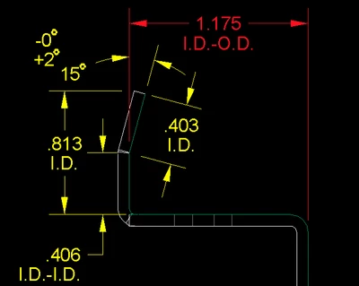

Hello, I have questions. Can I change the color of one dimension in a drawing on a plot? I am modifying the part and I would like to show the changed dimension, e.g. in red. I use a Cre parametric 2.0

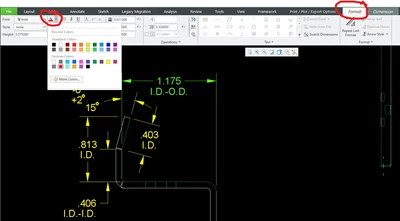

Select the dimension you want to change the color of, Format Tab then the color key in the upper right corner.
