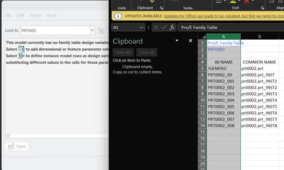

Jun 5, 2023 7:19 AM UTC
in Excel you have to select the right range ... see red rectangle in following picture

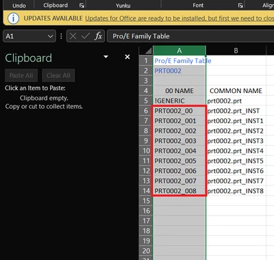

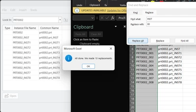

Jun 6, 2023 11:32 AM UTC
Oops., The problem is there is one more INST in the header which is also replaced as 00. Leaving that will not destroy the family table. Thanks.
