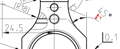

Change distance between Dim and curved line?
See this image:
The distance between 45° and the curved line is huge compared to the distance between 24.5 and its straight line, making it look a bit weird and inconsistent. I have searched in the config.pro but there doesn't seem to be any setting for this. Any ideas?

Try setting dimension Display to Parallel Fully Outside.

That's indeed an improvement! Thanks!
Thought though: - Why is it called "Parallel Fully Outside"?? Seems like a terrible confusing description considering what it actually does. 🤔😄
