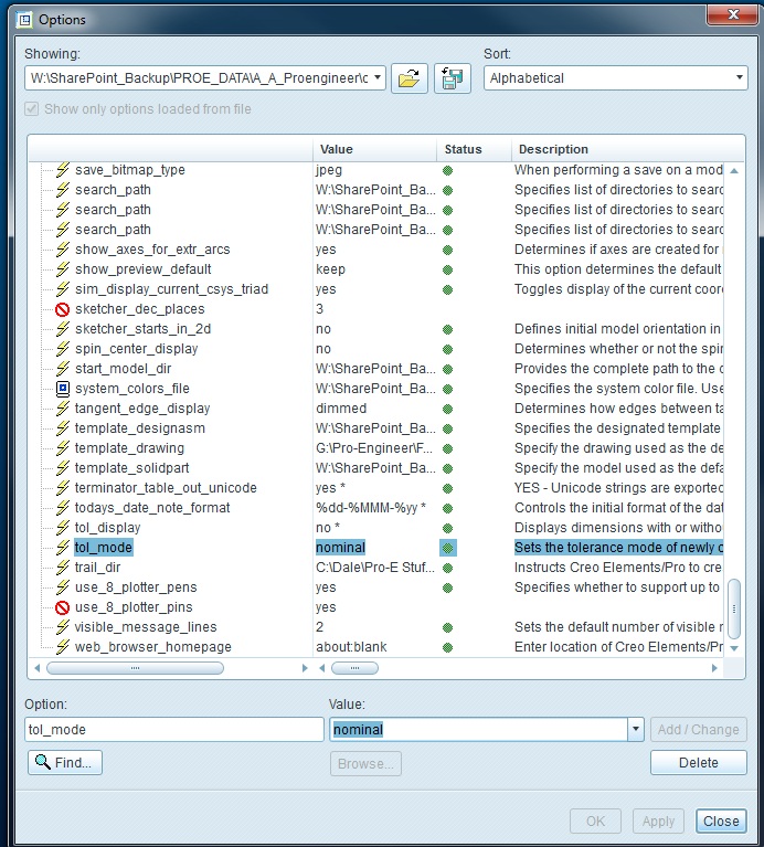

If you haven't found it already, go to Tools, Options:
Set the tol_mode to nominal.
Hope this helps. Dale
