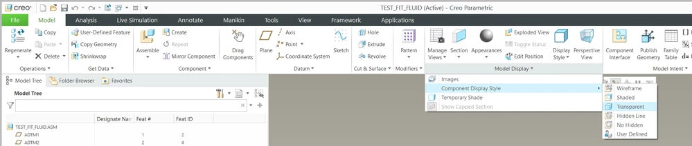

How can I make inactive parts transparent but keep there assigned color?

Thanks @tbraxton for your views,
This helps when transparent display style is desired for a given component, This won't help unfortunately however for the way how transparency will be displayed for inactive components (after having activated a given component in assembly mode).

Select the component and then set the component display to transparent in the view tab.
March 14, 2022
