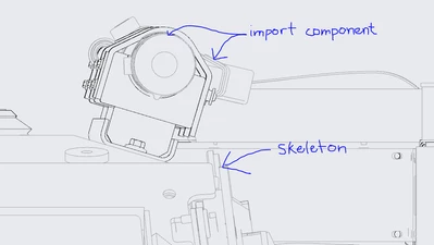

In my drawing I have several parts in my assembly that are imported quilts. Because of my appearance settings all quilts are designated to be gray, imported components come in grey. I cannot change this system appearance however because the base for my assembly is a skeleton and those are considered quilts so they need to be grey. How can I override the system appearance for a single component in the drawing. Using the component display option doesn't seem to override the system appearance.

2. A screenshot from the screen with your components would also be useful.

Sorry have mentioned that as well: Creo 7.0.4.0
