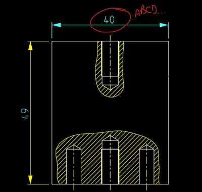

Hi I would to change the value of a quote buìy a text.
How can I do this?

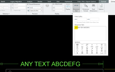

Feb 15, 2023 1:15 PM UTC
Change @D to @O (letter O) and type the text in you would like to display.

Feb 15, 2023 12:43 PM UTC
I truly do not have any idea what you are asking. What "quote" and what "text"? What are you actually trying to do?
Feb 15, 2023 1:03 PM UTC
I want to substitute the number with any text.
