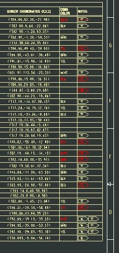

I have a parameter driven table with a comment column at the end of table in this column each cell gets notes and comments and many times a report symbol. Some of the cells I want to be a specific text color but I find it to change the entire column to the text of any cell color. I believed the comment column to be a dumb column with no unity to any other cells in the column. AM I missing anything here. I attached how I want it to look. Maybe there is a parameter to change text color in a line.
