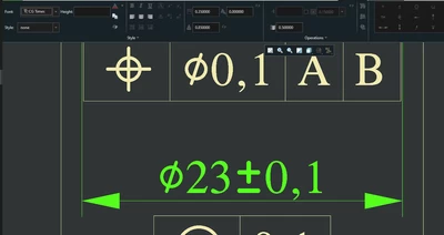

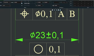

I noticed that after creating the drawing changing font of the annotation doesn't affect the embedded symbols like plus minus sign or diameter sign. For example dimension font is set as arial WGL first:
But setting it to CG times, only the dimension numbers (23 and 0.1) is changing but not symbols:
Is there a way to set font format for all symbols effecting the annotation on drawing?

I think your problem is related on setting of detailed option symbol_font in model and drawing.
