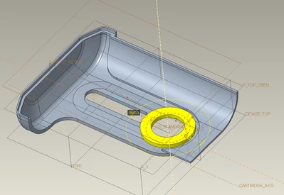

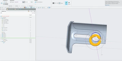

I am trying to change the axis of revolve to the blue circled feature. When I try to select "A_1", it doesn't let me do that. Could anyone please have a look at the attached zip folder which has the part file and let me know how to fix this?

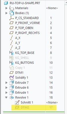

Is this what you need? If so, see enclosed model.
I added an internal plane to the revolve feature as seen here and rerouted the references of the revolve:

Looks like the Rotate selection box is not active.  Select the box next to rotate (currently InternalCL), it should turn green to indicate it is active, then select the new axis.
Jun 2, 2023 3:51 PM UTC
I tried that too, but axis A_1 is grayed out and I can't select that.
kdirth
Jun 2, 2023 4:01 PM UTC
Creo does not allow you to use the internal axis of another feature for an external axis of a revolve.  The best way to do this is to put an axis in your sketch colinear to A_1 or make an axis on top of A_1.

Jun 2, 2023 7:02 PM UTC
While in the feature tool, use the datum drop down menu on the right of the ribbon or go to the model tab to create the datum you need.
