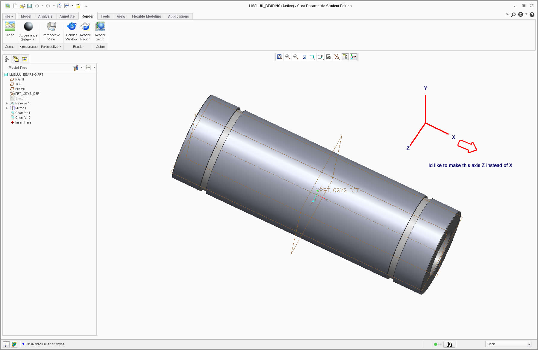

Hi guys, this is my first post, and I am glod to be here. I have searched for this, but Im just getting used to the forum interface and not sure If I am searching right.
I am wondering if it is possible to switch axes in a model. I am using Parametric 2.0 Student Edition to create files for 3d printing. I created two simple files while learning to use creo, and I realized that I created the models with the z axis in the wrong direction causing the model to sit improperly in my slicer program.
I can easily recreate these 2 models, but It would be great to also know if this is possible, and how to do it for future references.

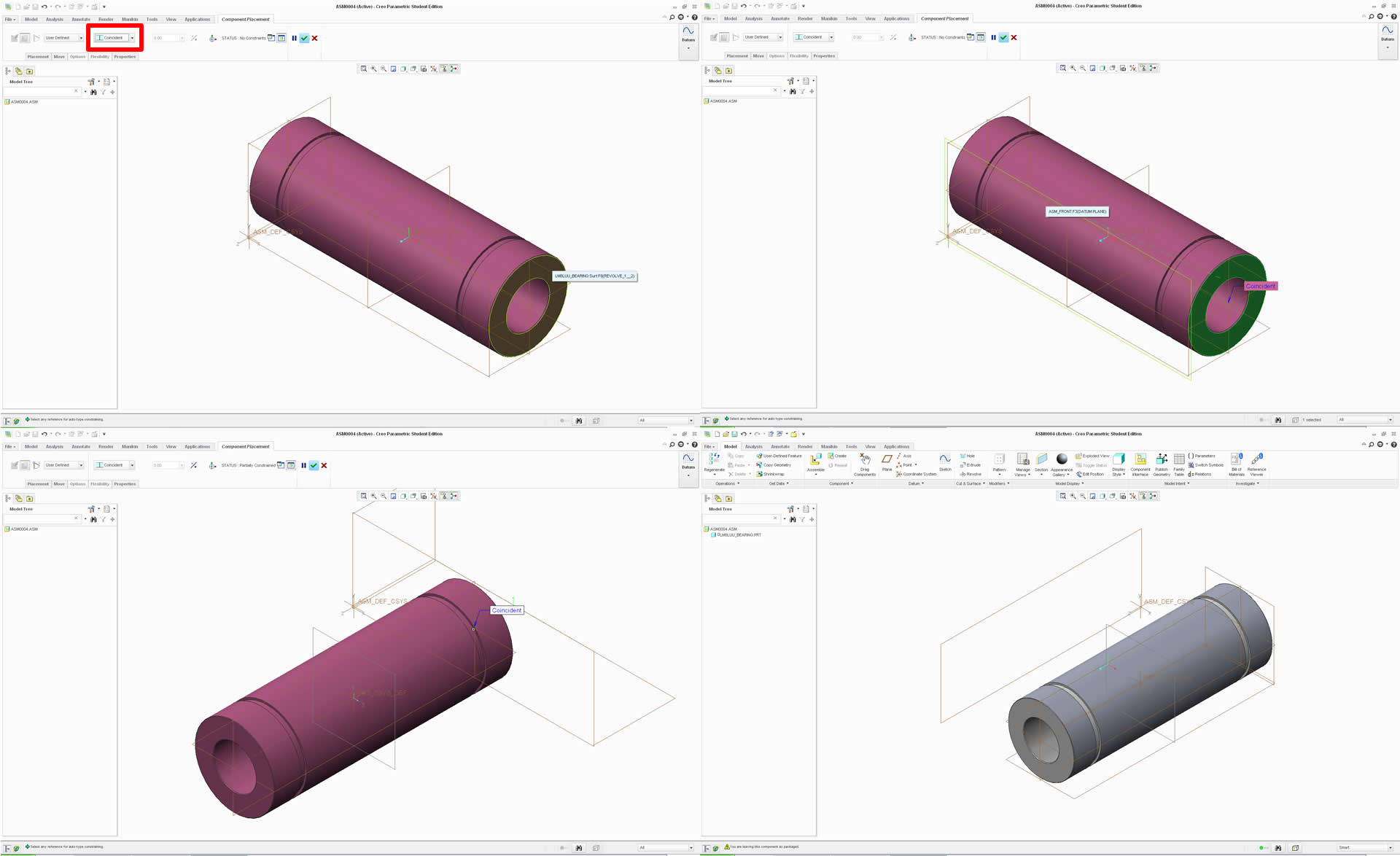

Best answer by j.angel
Oh Those were both perfect. Just did this in an assembly. Once the part was imported, I just used coincident to select the front face to the bearing and Front plane. Turned it just right. Here is a pic.

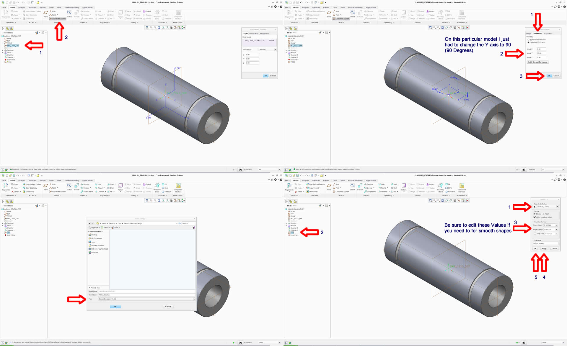

Also, it worked in just the part file, by assigning and newly created coordinate system as you suggested. Here is a pic.

Hi James.
As with most things Creo (was ProE) the answer is sort of.
Did you make your model with a coordinate system or default datum planes in it?
With either of these you can make an additional coordinate system relative to the first coordinate system or the datum planes and you can select which axis is called what and which way it is pointing at that time. Then call up this added coordinate system in your slicer program.
You can add a coordinate system just from orthogonal geometry too.
If you can only reference your base coordinate system then I am afraid you will have to recreate your geometry but I doubt that is the case.
Hope this helps.
Regards. Brent
j.angel1-VisitorAuthor
March 27, 2013
Hi Brent, Thank you for taking the time.
I am new to Parametric, however I am sure I simply selected "front" on the left pane and selected "sketch" in order to start building the part using lines, then revolve then mirror.
It is a linear bearing I created. I didnt know it at the time but the orientation matters when building from what I can tell, and this bearing has the z axis pointing to the side of the bearing vs parralel to the center shaft opening.
Is there a guide or a detailed way to turn the x axis into the z axis?
Attached is a pic of the way it is now.
March 27, 2013
I am not sure what your slicer program is. In general, orientation of Creo parts doesn't matter since you can orient them any way you want in the assembly. When you export a file you often have the option to assign a different coordinate system to the export so you can orient the part at that point.
If you want to reconstruct the part, you can choose a different sketch plane for each feature. This will be some extra work but it can be done.
Last but not least, you can assemble the part into an assembly and orient the part with the correct Z in the assembly.
Again, it depends on what you are doing in how you want to change this part.
