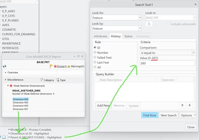

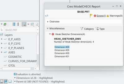

Background: We use ModelCHECK to check for weak dimensions in sketches. Eventually we found weak dimensions in sketches of surfaces splits within Simulate. Currently it seems one has to switch to Simulate to check for non-compliant features.

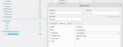

That is an interesting thought. The data is definitely in the file.
As stated in the opening post the ID 380 cannot be found in Creo directly. Neither in the Navigator, no via Search Tool (max ID 367)
Using a text editor I can confirm that the ID exists
Switching to Simulate, the Search Tool shows more available IDs (max ID 381)

The Divide Surface dimensions can be found using the Search Tool in Creo Parametric if searching for Driving Dimensions, ID is equal to 28.
This is going to find that d28 is related to a Divide Surface feature in the found results but since this feature is still unavailable in Creo Parametric, adding it to the Selected side of the Search tool is not going to add it to the selected, but there is not much, if anything, that can be done with this Creo Simulate feature in Creo Parametric
