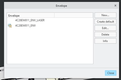

in CREO ADVANCED PLUS 9, i've created 2 default envelope: how can I choose to consider one of the envelopes in a new simplified representation in an upper assembly?

Have you attempted to use this method already?
To Create a Default Envelope Simplified Representation
To add new envelope parts as simplified representations, right-click the default envelope representation and choose Redefine from the shortcut menu. When there are multiple envelopes that meet the criteria for the default envelope, you can redefine the current representation and select a different envelope from the Select Envelope dialog box.
tbraxton
tbraxton22-Sapphire IIAnswer
Nov 14, 2024 4:40 PM UTC
