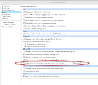

in CID/WID design you need to set the following :
  • mates_with parameter - this parameter hold the value to look for in order to find the the mate connector in the catalog
  • in options dialog , Design tab -> you need to set the parameter name which hold above value (in which parameter Creo Schematics will look for the above value) , i.e. :
    in this example , Creo Schematics will look for mate connector which have the value defined in mates_with (in the component) in parameter part_number (in the connector)
  • num_of pins - if defined in connector Dataset - connector will b created with proper number of pins (members/ports)
