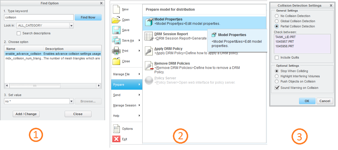

I believe the collision detection setting is what I'm looking for... but is there a way to stop the parts from moving into each other instead of showing it?
September 2, 2016
Hi axu
This could help...
Kulbir
