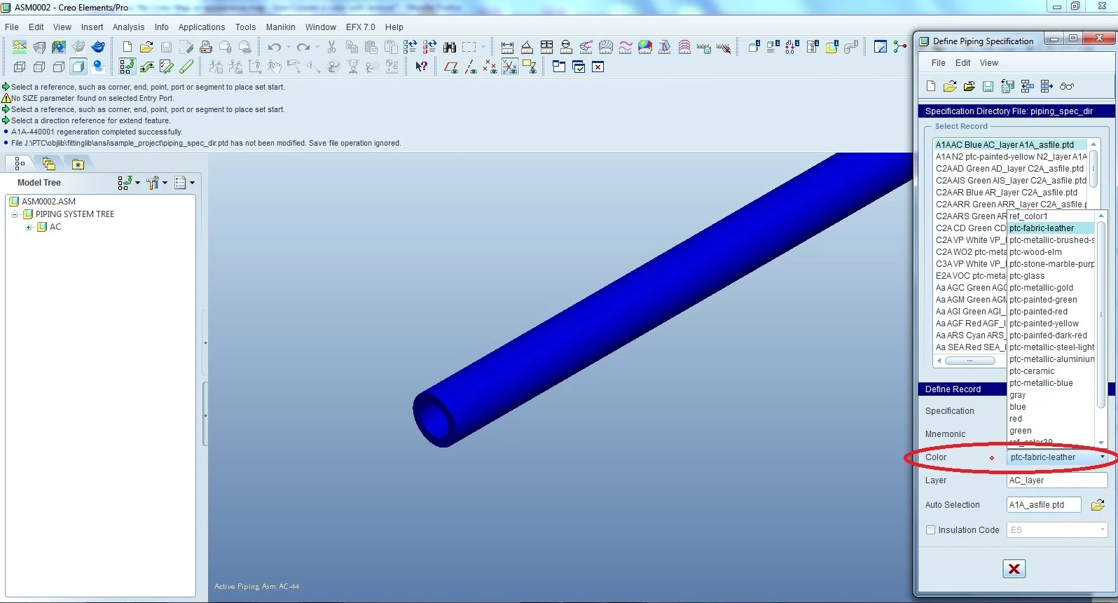

Hello Mr. Rocha,
Did you find a solution ?
I try to add an appearence on this piping map file and I have the same issue on Creo 2.
Thanks in advance
