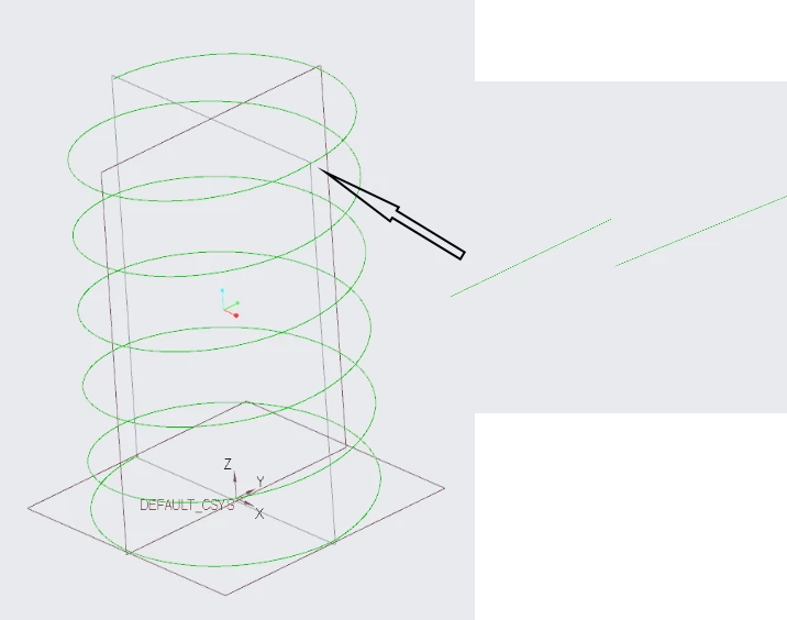

I was wondering if there is a way to combine/merge three curves made with equations into one curve.
As you can see in the attached files, the curves form a spring.
If zoomed in, little differences between the curves can be seen.
I'm looking for a way to eliminate these gaps and get one whole curve out of three.
Thank you for your time and with best regards.

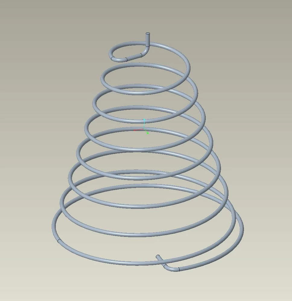

The spring shown below transitions from a helical path to a planar one at both ends. This model uses curves on each end that match the helix to deal with the discontinuity. This approach can also be used to resolve your issue but is more tedious than adding the fillets between curves.Helical coil with transition to planar endsHelical coil with transition to planar ends

Thing is, as you can see in the attached picture, the whole curve cannot be modeled within one equation-driven curve because the z-coordinate is seperated into three functions, depending on a parameter. At the bottom and the top, a half of a circle is needed on the same z-coordinate, while between the top and the bottom a helix form is needed. To my knowledge it is not possible to use if-conditions in an equation.

After all I found a workaround: It was possible to extract points along all three curves and then create one curve interpolating these points. The result was quite accurate and could be successfully exported.
