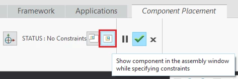

We have been tweaking our config.pro lately, adjusting settings which we normaly set by hand.
So one setting is the comp_assemble_start, which we have set at contrain_in_window. When adding a new component to an assembly, this setting will show a new window for that component.
But the component is not being shown in the main 3D window. We have to click the button "Show component in the assembly window while specifying constraints"
So searching for more config options, I encounter display_comps_to_assemble, which we have set to yes, but nothing happens. It seems like Creo is ignoring that setting.
Does anyone know how to fix this?

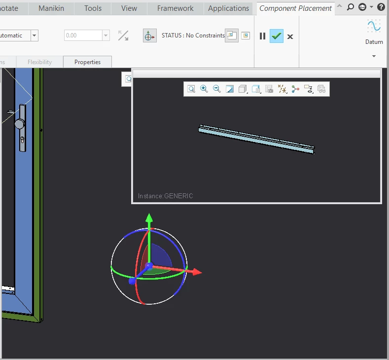

Here's what we now have:
As you can see, the component being placed has it's own window, but it is not being shown in the window of the assembly.

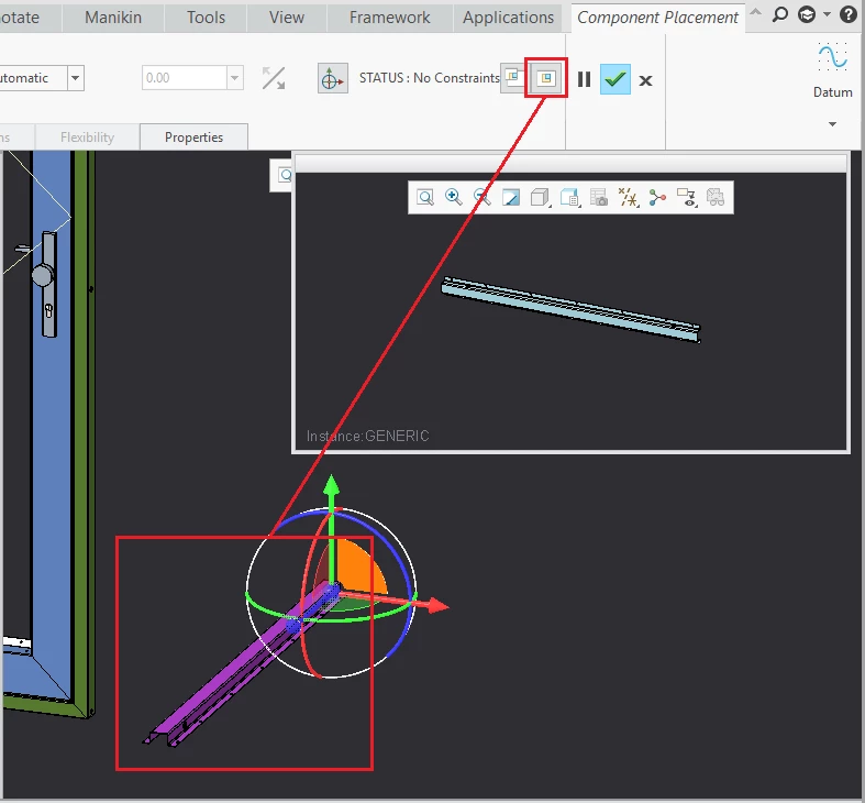

This is what we want:
You can now see the component being placed in the assembly window too (in purple). I believe that display_comps_to_assemble controls that button, but it looks like Creo ignores it.

I have my config value as move_then_place for comp_assemble_start, my first pick it to drop the component somewhere within the assembly then I can select the show component in separate window button and I can see the component in a window as well as in the assembly. You can select references for either place as well.

If I set display_comps_to_assemble to yes and comp_assemble_start to move_than_place, then the new component is inserted visible into the assembly, but I loose the "move" part of the comp_assemble_start
Something keeps conflicting with these two settings...one setting disrupts the other...
Nov 18, 2019 2:43 PM UTC
I do not have display_comps_to_assemble set explicitly, by default it is set to yes. To move the component I have to RMB in the graphics window and select  "Move Component", then I can drag the component around.
