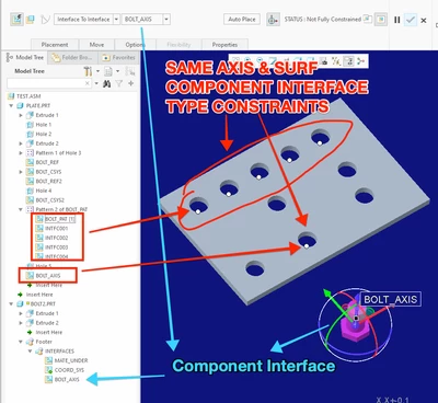

Ok - I am going to ask a really dumb question about Component Interfaces.
I have noticed that if you define MULTIPLE Component Interfaces with the SAME Reference Types (e.g. Axis and Surface References) defined in a model.... Creo can be too greedy/generic in their presentation as options.
So.... When you go to place a component using an Interface-To-Interface Type....  Creo will automatically include ALL of the possible Component Interfaces (even if they are a different name?!?).... This seems to be dependent on the Reference Types defined vs just the Component Interface Names?
Is this really how this works.    Or am I not seeing / overlooking something.
I would have thought -- Assemble BOLT_AXIS in One Part would automagically only be constrained to the SAME Component Interface NAME in the target Assembly?  But this appears to not be the case - or is there another way to make that happen.  There appears to be no way to force / limit selections between two models via Interface Names - only the thing you are assembling?

You're correct in assuming that the "name" of the interface actually doesn't really affect the performance of component interfaces.

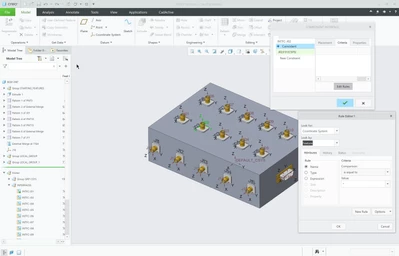

To help "limit" the list of possible options... have you tried looking into the component interface "Criteria"? This sounds like what you're looking for.
Essentially, this helps enforce rules to what possible mating interfaces are allowed.
We use these with our Toolkit applications/automation to help define mating conditions for bolts, electrical connectors, etc.
For example, we make it so that an Interface on a box for a DSUB connector (using the coordinate system) can only mate to another coordinate system feature of a certain name (aka "CONNECTOR_MATE"). Or better yet, by checking against a parameter on the mating feature.
My personal recommendation - try to also define each interface specifically as "Placing" or "Receiving". This helps when helping enforce the assembly constraining reference structure.
