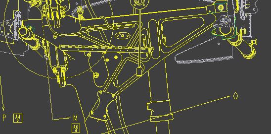

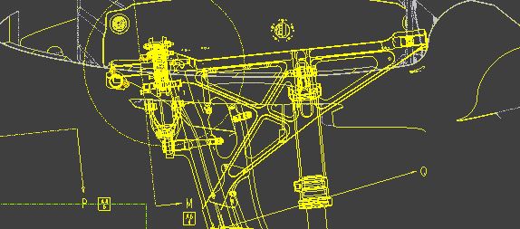

I have a component in a large assembly that displays fine (no hidden lines, tangent lines dimmed) normally, but when I show a cross section (that doesn't intersect the component at all) the component displays as wireframe and I can't change it?? Any ideas or thoughts?
I've tried excluding this component from the cross section (even though it's untouched) to no avail.
I am working in Creo 2

with cross section (which is placed 30 inches away from the part)
no cross section in view

Is it an imported component, possibly a surfaces model?
If so, you need to create a section using the Solids & Quilts (something like that).
dcoauette1-VisitorAuthor
April 3, 2014
It is an important component and is a surface. So even if the cross section doesn't touch the part I still have to ensure that I choose solids and quilts? Seems a little weird to me, but thanks I'll give it a try. Any other comments are helpful.
