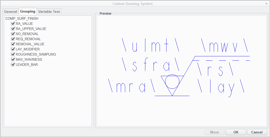

Okay, so we have a symbol editor and I decide to make my own so I won't be slammed by a customer next time.
Am I really missing something or is it as bad as I found it to be?
'nuf whining... and for those of you who need a comprehensive surface finish, please find the attached symbol for your unrestricted use.
I tried to capture everything found in the Machinery's Handbook.
The attached symbol is Creo 2.0. Not sure if it is downward compatable.
The following might help you recreate this from the generic default SF...
On the left are the groups (see video on which features are grouped together); on the right is the default SF with my modifications.

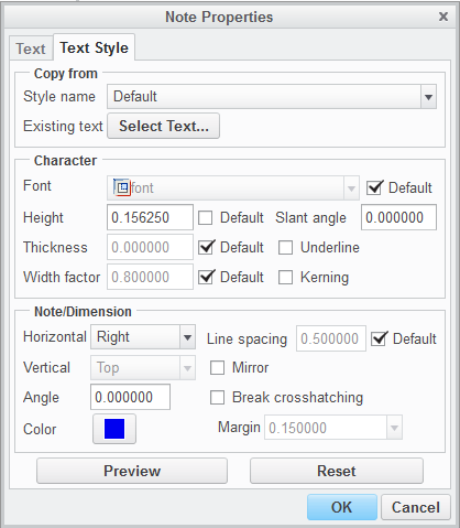

Also be sure to change the text properties to the following so it will follow your drawing defaults.
Just remember to left and right justify the variables as appropriate.
All the Var Text type attributes are "Text" so you can use commas for metric standards values.
The only other thing that bit me was the line colors. You have to select "leader" from line style or "Letter" for line style color.
