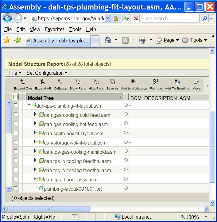

I've been trying to find out how to create the compressed Productview thumbnails shown in PTC's Productview demo. The ship demo.
3. In the Parameters|Miscellaneous tab in the recipe editor specify the level of thumbnail creation. This is the level within the hierarchy where the thumbnails that are shown in the movie are created. Level 1 means : create a thumbnail for all sub-assemblies at level one in the hierarchy. Level 2 means second level , etc. The choice of level depends on how the data is structured. An assembly with lots of sub-assemblies of the root node, for example, would work well with "level 1". If the structure is more evenly distributed you may want to add the thumbnails at level 2. Currently, you can only specify that assembly thumbnails get published for a single level (whether it is 1, 2, etc.)
4. Save the recipe file
5. Run the pvsthumb executable (it's in the bin folder under (typically) c:\ptc\productview_adapters ) with the recipe file just created as follows:
pvsthumb <recipe file="> <pvs file="> -o <new pvs=" file=" name=">
e.g. pvsthumb thumb.rcp mypvs.pvs -o mypvswiththumbnails.pvs
This can take some time for huge assemblies (maybe an hour or more). It will create a bunch of .pvt files (3D thumbnails - they're actually .ol files renamed) and a new pvs file.
Load the pvs file into ProductView. If it's 9.1. I believe you should see the 3D thunbnails load automatically. You can drill down by double clicking on the 3D thumbnails.
My results are:
Only three new files are created. A .pvs file, a .jpg file, and a .pvt file.
No new .pvs's got created for the existing .ol files.
I tried this with the recipe file set for level 1 and level 2. Same results.
file=pvsthumb-rcp
ver=5
lastp=spec
adapter/createSubModel=1
The command to create the 3d-thumbnails
C:\ptc\cad_viewables\thumb_test\level_1>C:\ptc\productview_adapters\bin\pvsthumb.exe C:\ptc\productview_adapters\bin\3d_thumb_level_1.rcp dah-tps-plumbing-fit-layout_asm.pvs -o thumbnail_level_1.pvs

My model structure looks like this. Which I think should give me at least 8 compressed thumbnails.
[cid:image001.png@01CB9B7A.6DB9CE40]
Anyone know what I'm doing wrong?
