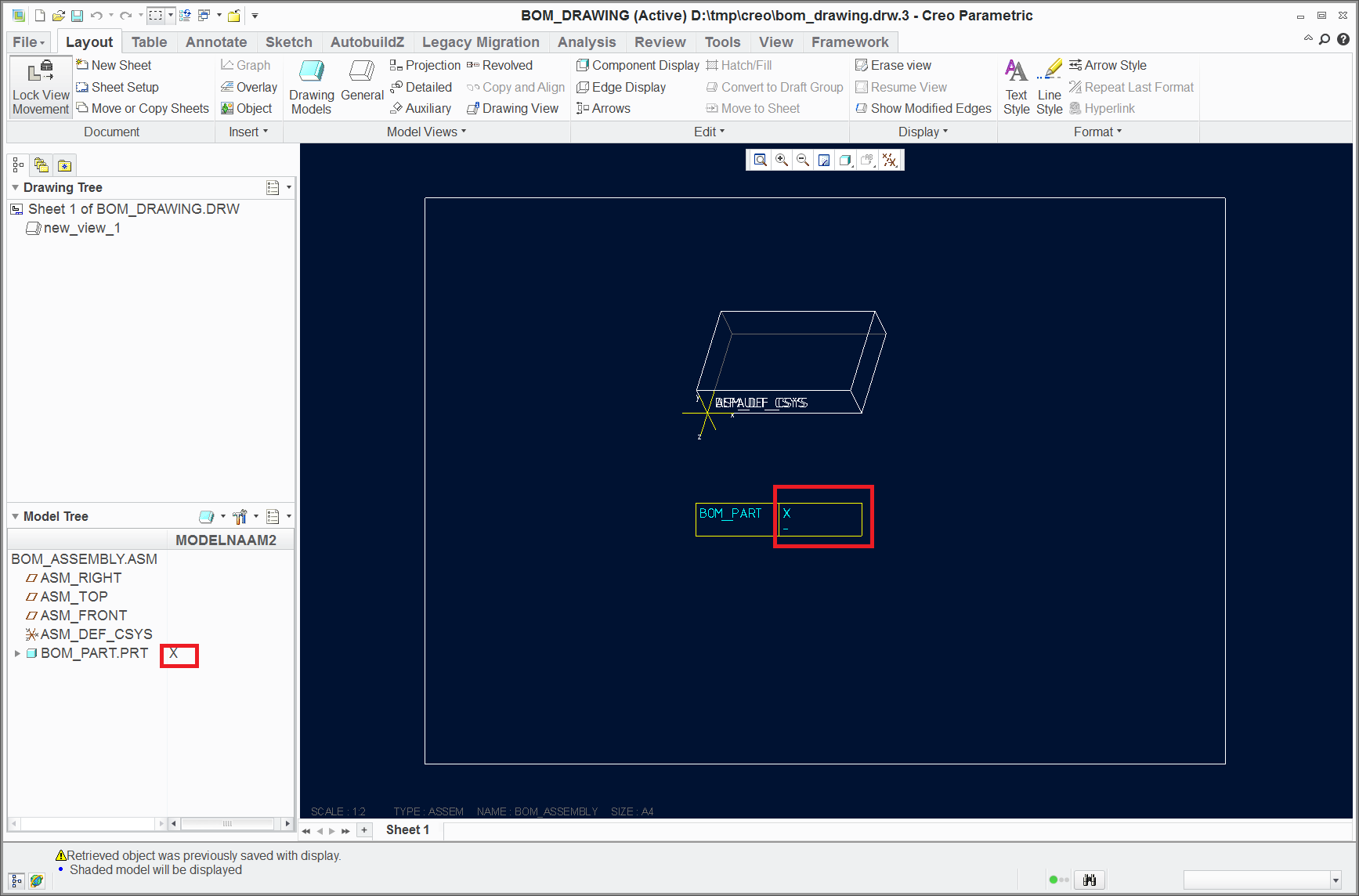

Can someone help me with the following:
When an article in an assembly comes from a certain supplier I want to hide the stocknumber of that particulair part in the BOM
Changing all the separate parts is too much work so I want to apply the filter in the drawing of the assembly.
So far I have tried to apply conditional formatting in the region relations of the drawing of the assembly
if asm_mbr_modelnaam2=="X"
asm_mbr_artikelnummer="-"
endif
But nothing happens.......what could be the cause?
the columns appear in the sort region text as  &rpt.rel.modelnaam2 and &asm.mbr.artikelnummer but entering those texts can not be verified

Suzanne,
I created test data in CR2 M070...
Open bom_drawing.drw and set model tree column for MODELNAAM2.
In model tree, change empty string to X and update drawing sheet.
Repeat region definition:
Repeat region relations:
  ARTIKELNUMMER2="-"
else
  ARTIKELNUMMER2=asm_mbr_name
endif
Martin Hanak
