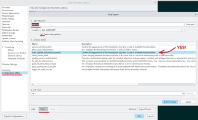

Chris3
Jun 12, 2023 5:43 PM UTC
auto_update_intersected_models no
Jun 12, 2023 9:22 PM UTC
FYI, the find tool in the configuration editor sometimes works well to get you the answer:
