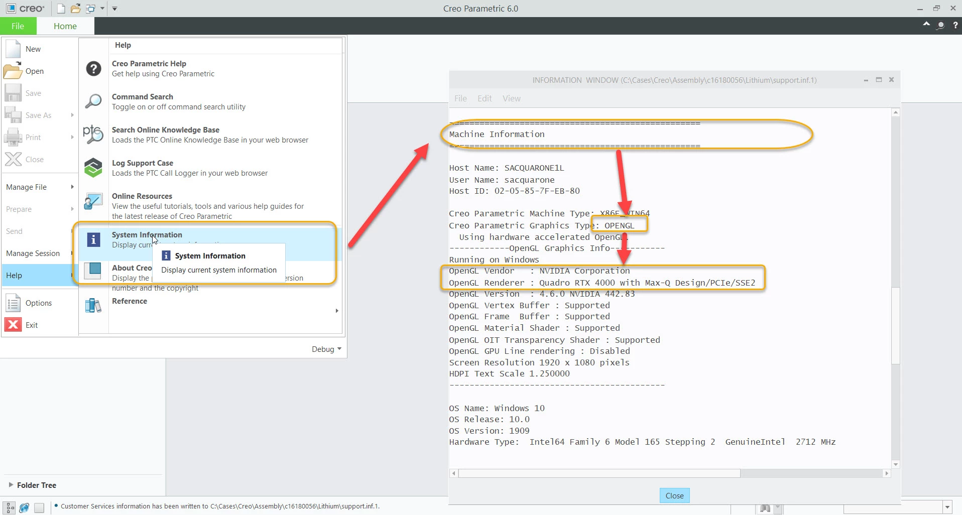

I am using Creo Parametric - Release 6.0 (connected) 6.0 6.0.1.0
How to define the use of the external graphic card (quadro p4000) instead of the UHD gpu processor?

Hello @CT_3061223
Usually, if cable plugs from NVIDIA graphic card to the monitor, the graphic card should be considered automatically.
ARe you sure Creo Parametric considers UHD gpu processor instead of expected NVIDIA quadro p4000 card?
You may want to verify this after startup of Creo Parametric, access to >File >System Information, and scroll down to the OpenGL Graphics Info section of Machine Information table, as shown in attached snapshot. If you see something different, please attach a snapshot of what you're seeing in this section for eventual further guidance.

Hi Serge,
I have check that just before your reply and ... You're right! 🙂
Cables were not connected to the graphic card!
