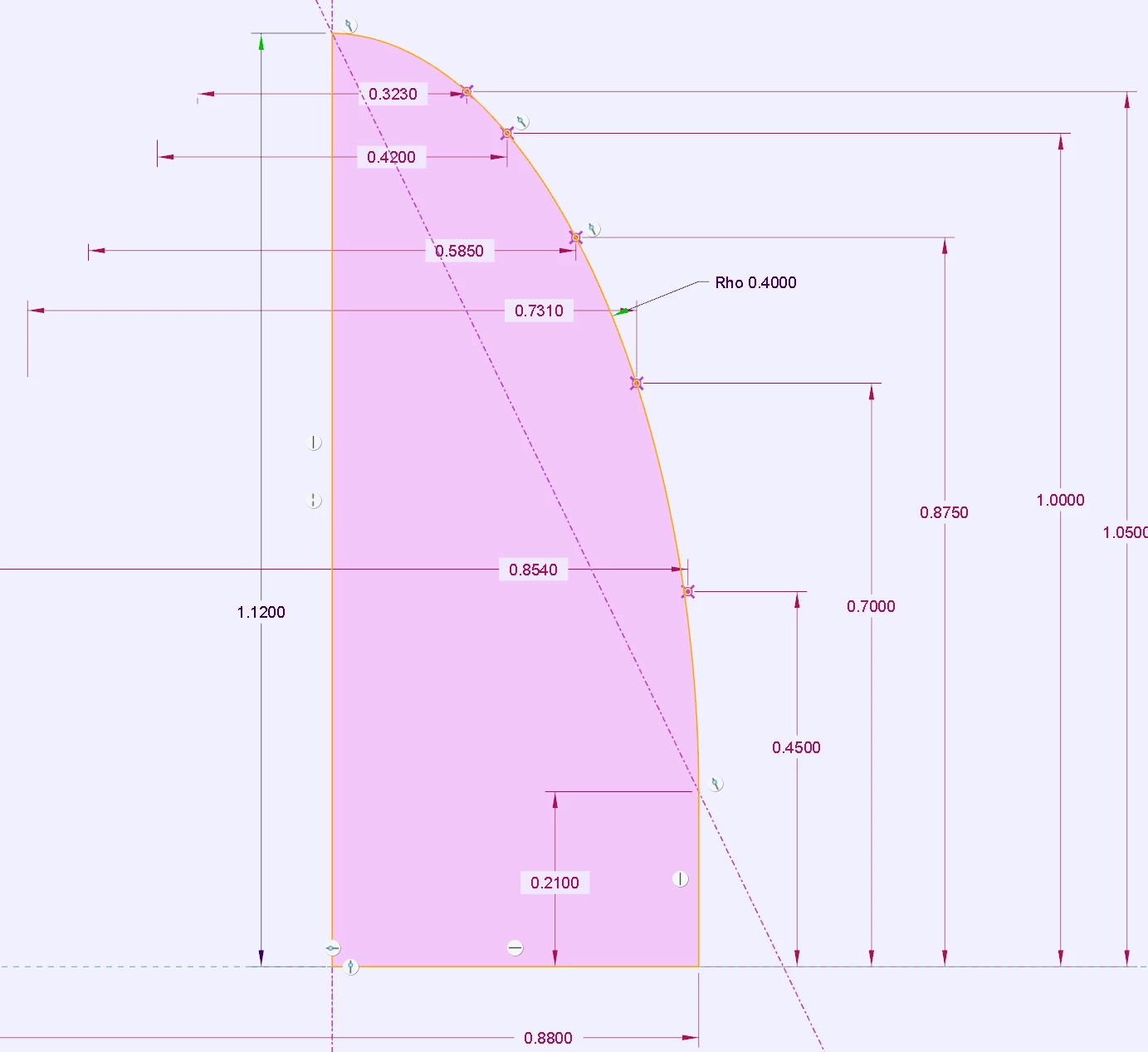

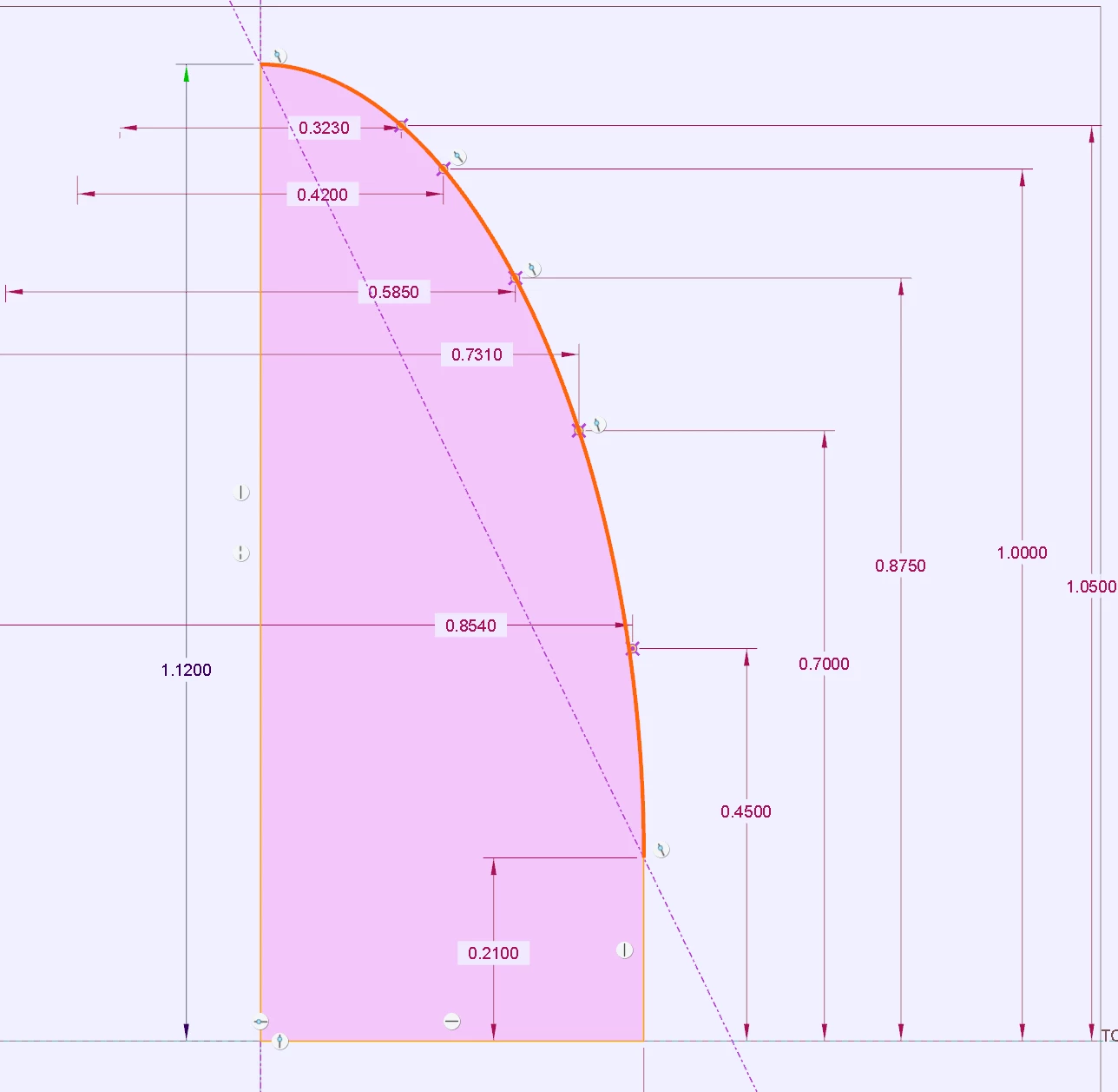

Hello everybody
It seems that the limit to constraint a conic arc is 4 points. I picked the start and end point and lay the arc as close to the 5 sketch points. Then i apply the constraints but it wont let me pick more than 4 unless i start making other dimensions References  like the Rho, etc.
any ideas. i need to keep the Radius (Rh), so a Spline feature will not work and neither a Curve by points.
i guess i can go back to Manufacturing and delete the rest of the sketcher points.
thanks

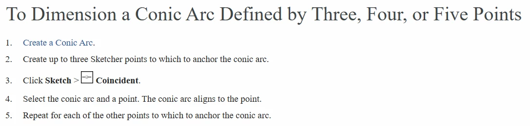

PTC documentation implies that you can use 5 points to define a conic arc in sketch mode. This of course would require that the curve would actually contain these points as the conic arc is defined using a mathematical function (equation of the curve).
I would first verify that the points are in fact defined by a conic arc (an ellipse for rho=0.4). If the points are not on said curve, then this is not going to be a valid set of sketch constraints. Also note that the end point conditions of the arc (tangent etc.) also serve to constrain the definition of the conic so that can make alignment to points redundant constraints.
Have you attempted to use the following technique? The start and end point are included here I think such that you can have 3 “internal” points used to define a conic arc.

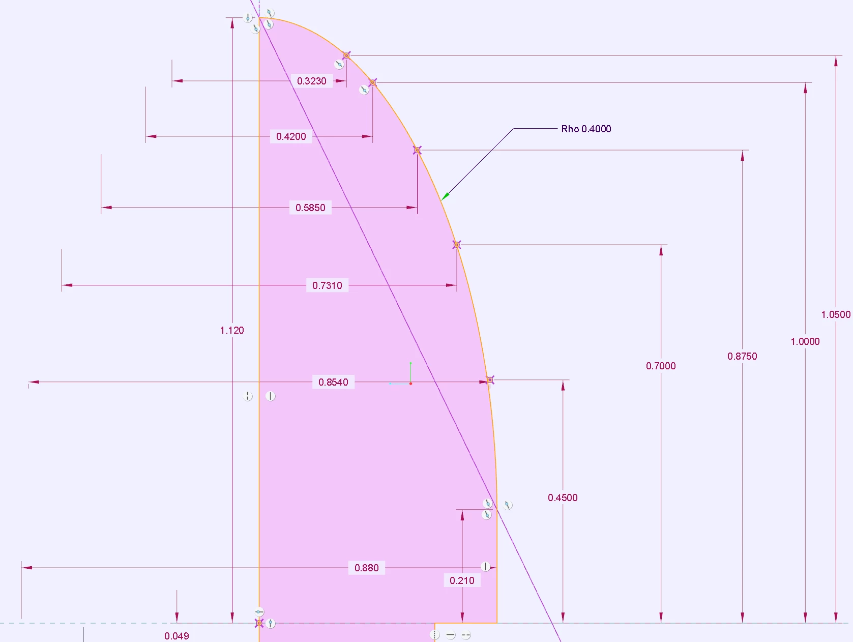

i have attempted different ways. I noticed the tangent constraints and Rho dim count towards the anchor limit.
Here is 3 point constraint + ends (2) = 5
Here is 2 point constraint + ends (2) + Rho = 5
Here is 1 constraint point + ends (2) + Rho + tangent = 5

I would confirm that the coordinates actually lie on the curve, it is possible that the points are not all defined by a conic with rho=0.4.  If the rho value must be set to 0.4 for a conic arc then the curve is an ellipse. You can check this by using the equation for an ellipse and using the (x,y) coordinate values with to verify that the ellipse does pass through all of the points.
You can use curve from equation function to plot an ellipse in Creo or manually calculate the function values to confirm these points would lie on a given curve.
The parametric equations of an ellipse centered at the origin are x = a cos(θ) and y = b sin(θ), where a and b are the semi-major and semi-minor axes, and θ ranges from 0 to 2π.
