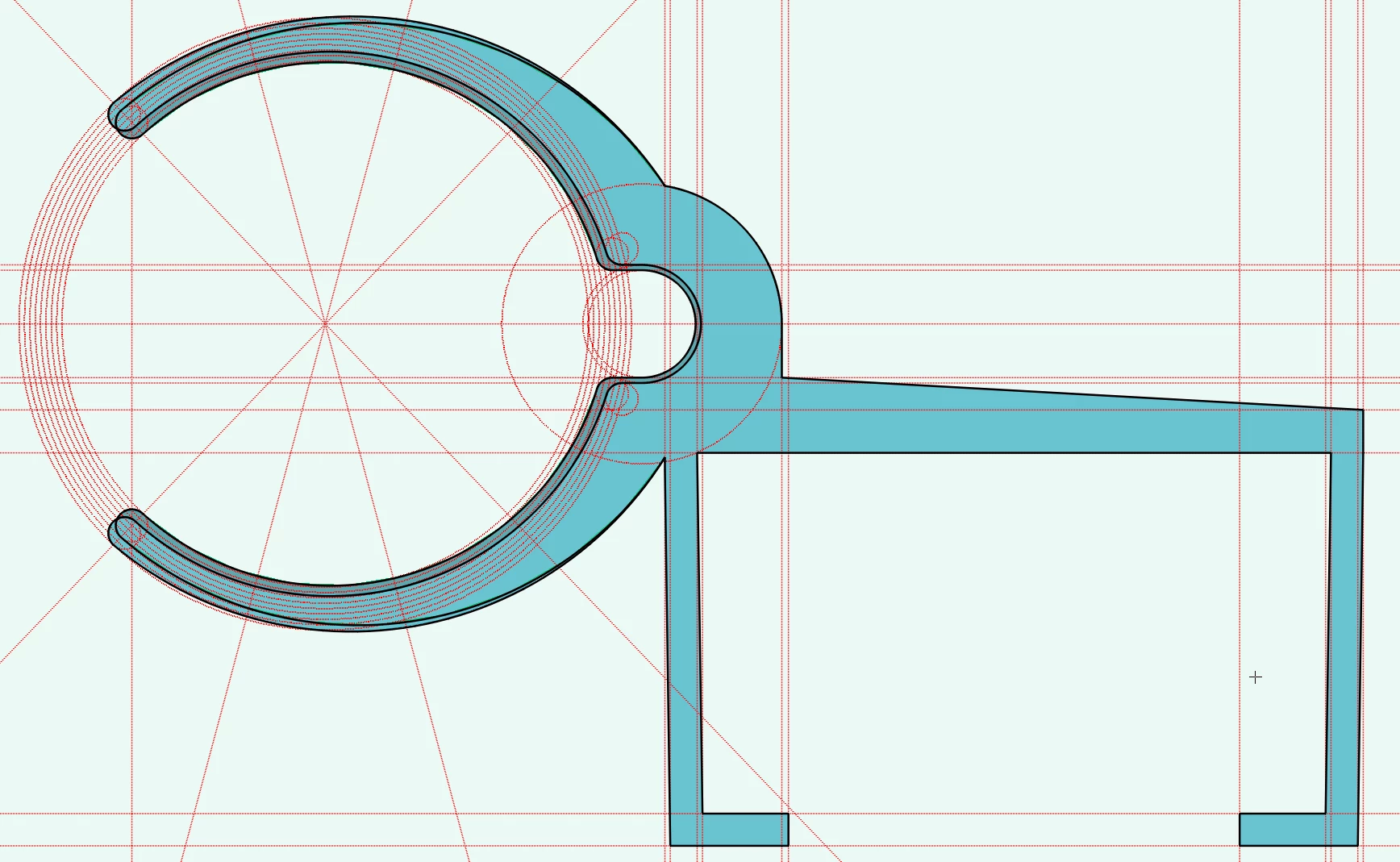

Hi community people,
I am VERY unfamiliar with 3D drawing tools, so please bear with me...
I am trying to create an object, which "almost" is a 2-D drawing, which must be pulled 30mm.
But the Top/Bottom surfaces are a little bit different.
I have tried to define 2 surfaces "Top"/"Bottom", but I do not know how to combine these and add the missing surfaces.
I have tried to use "Gather Faces" without success
Am I doing it totally wrong?
Best regards
Martin
PS: I am using "CREO Elements Direct".
February 11, 2017
I actually figured it out myself (after watching 50+ videos).
I created a parallel copy of the workspace, and used Loft...
KenFarley
February 13, 2017
My first try would be a "blend" feature. I would not bother creating individual surfaces. You define the two sketches at the parallel distance you need.
