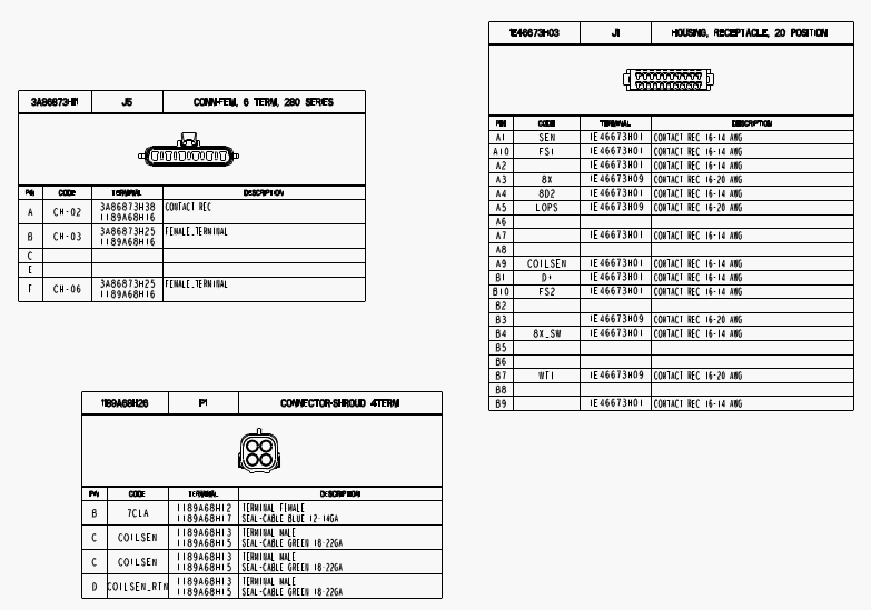

Hello All,
First time poster in need of help. I created connector pin-out tables in my drawing, and used model /rep to poulate them. Some of the cells in my table will not populate. One connector has pins a thru f, but the table omitted -pin "d". Two tables have missing signal names in one column. I cheked to make sure these parameters were filled out in the connector parameters. Double checked to ensure the wires were routed correctly. I also verified the info from the XML file was the same. Everything seems correct, but I stll have empty cells. Has anyone seen this before?
Thank you in advance.

Is there a way that you can upload your files or include a couple of pictures to help explain?

Dale,
Does this help? The rows that are entirely empty, should be, but the missing info on the other rows should populate.
Connector P! has 2 row "C's", I have no idea why that happened.
