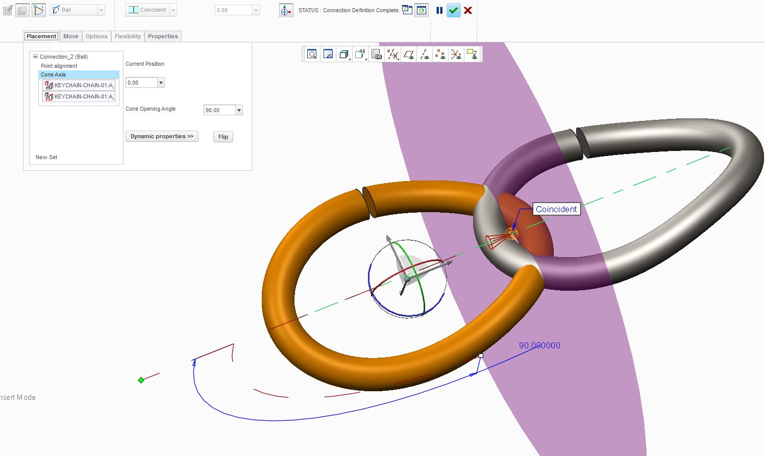

I am trying to create a chain in Creo and encounter the same problem.
ball joint seems the most suitable connection type to simply connect two chain links, you are able to limit the "cone opening angle" in Creo 2, but the cone is always 360 degrees revolved. It would be nice if I could set limits for this to avoid interference! Does anyone know how to succesfully avoid this?

You'll need to use two pin joints.
