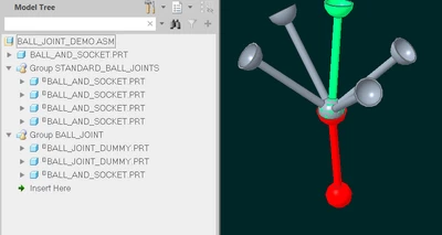

Glad it worked out.  It sounds like you had a good learning experience; for me, it affirmed that avoiding motion skeletons is the way to go.
If you are interested, I attached a toy model with the simple ball joints (gray) and the more complicated 3-pin-joint construction which allows angular limits in 2 directions (green):

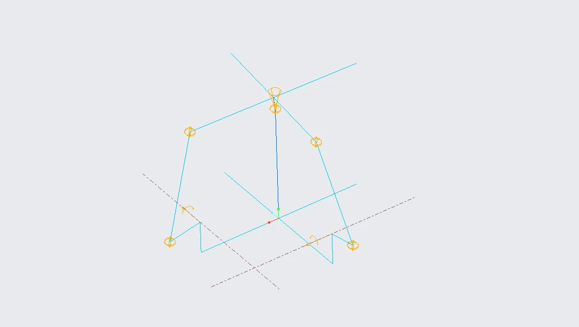

I attached a basic screenshot of the skeleton model. Please compare it to the youtube video in the original post if you can. Essentially there are 4 rod end ball joints (like these) that connect the motor arms to the platform. They give the platform some rotational wiggle room when the platform swivels, but don't allow for extreme angles due to how their connection with the motor arms are.
The first screenshot is a standard orientation for the table. The second is an example of the extreme rotation that occurs because the skeleton model's ball joints cannot be constrained, which is obviously not desired. You can see in the video that the supports move in the same plane as the motor arms, but only have so much room to move to the left and right of that plane.
Essentially I'm asking how the best way to simulate the ball joint rod ends in a motion skeleton. Does that make sense?

The cone angle seems to work well to simulate the physical limits of the ball end shaft hitting the edges of the mating socket.  I imagine some ball joint designs allow/restrict more motion in one direction - in that case, you would need something more like elliptical cone, which does not exist in Creo.  So, you end up constructing a kinematic ball joint out of 3 mutually perpendicular pin joints and place the angular limits on each axis' motion...
