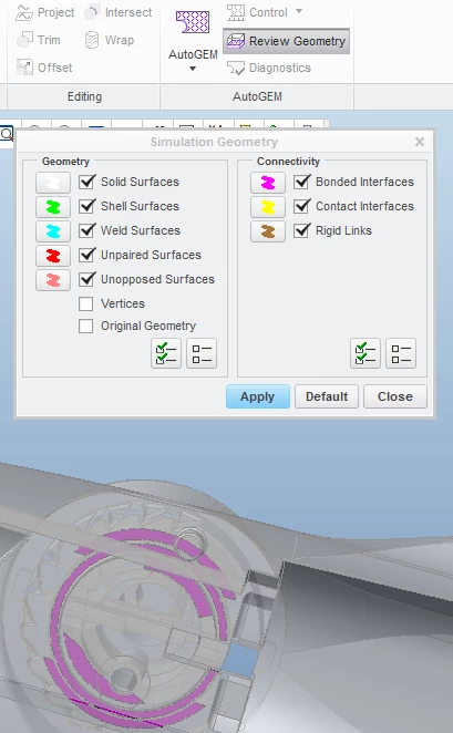

Did you create the contact region yourself? The first thing I would suggest is to check how your default behavior is set for contact - my guess is it may be set to "bonded". You can check for the behavior graphically using the command "Review Geometry" - this example has mine set to "Bonded" as I believe is the default:
[cid:image003.png@01CEFB3D.CD256580]
Hope this helps.

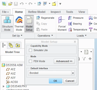

What version are you using? Component interface behavior is detected automatically for you (for the last few versions), and defaults to "bonded" for surfaces that are in contact. Unfortunately, icons are never created to visually indicate this after the assembly is fully transferred into Mechanica - that's why you need to use the tool I showed in my previous e-mail to see how Mechanica/Simulate has handled components that are adjacent to each other. My images have been from Creo2 (see below). This is behavior that I'd like to see changed - create interface icons for everything automatically generated ... or at least create model tree entries for all interfaces, not just user created.
Rod brings up a very good point too about creating contact pairs for all possible surface combinations. Creo 3 or 4 will allow you to select multiple surfaces from each body in just one contact definition - this will be a huge help . My recommendation is to set the default behavior to "Free" and manually create every interface you require for all pairs of surfaces that may come into contact.

Thanks Chris, yes, I did accept Bonded as the default Interface going in,
but then intentionally defined the individual Contact Regions as described.
That overrides the Default. But, I see what you're saying, if the Default
is Bonded, the interface doesn't show you anything that tells you that for
an individual surface pair. In my work things are almost always Bonded so I
have never considered the fact that it should tell you that. In full
disclosure, there is the reminder text at the bottom of the screen...
