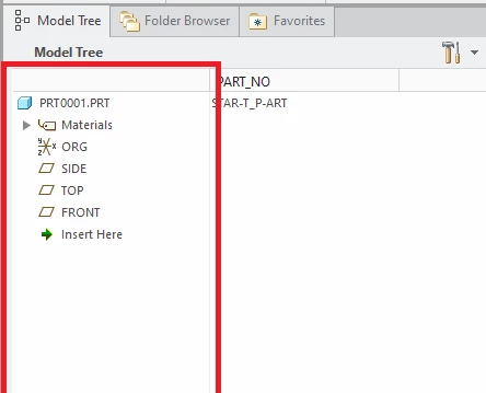

Hi
I'm using the Creo ver 4.0 m100.
I'd like to know size control option of Model tree feature structure.
please look at the below image (in Red box)
please help me

In Creo 4 you can create a tree.cfg file to define the configuration of the model tree.  You can then load a .cfg at any time to alter the tree configuration.
Links to ref materials:
How to auto configure model tree
save tree settings
