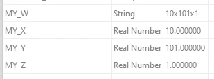

I'm using creo 9.0.8.0 and need a formula to calculate the Blank weight.
Usually we write the dimensions down in a parameter like this 10x101x1. I did change it to 6 separate Parameters so that i have 3 for the number and 3 for the decimal places . I multiply the normal numbers in a relation to get the weight and merge the parameters to a single Parameter for the bom.
now the problem:
some of my colleges say its to complicated and time consuming to fill in those measurements and i need a simplier way of doing it. My new way to do it is by extracting the measurements from a single parameter.
The Problem with this solution is that creo cant calculate it that way because it says theyre all Strings and not integers.
Any ideas how to calculate it? Or make it easier?
PRO_MP_MASS is showing the current weight and not the blank one. And getting the numbers from the first profile isnt an option.
If you want i can provide you the current relation/params/part.
thanks in adavance

We make make big stamping tools, so every prt we create is unique, a tool can easily get up to 500-1000prts if we would make for every prt a block to get the weight it would be to much time we waste just for it. Also our parts are to 99% made in house without a drawing for 95% of them, so its just showing the prt in the BOM.
We need the blank block weight and not the creo provided weight,
The dimension can't be extracted from the part like you say, because we are not only cutting out material from an existing block, were also adding, so it's not a reliable solution.
I need to make it in a string, because some of my collegues complain that it's too complicated with six parameters, before we had a single string, what they want to have back. So i need to convert it to numbers so that the relation is executable and calculates the weight.
As mentioned before, i need the 6 params to realise the ,00 at the end of some measurements.
It would be easy if the bounding box would show the the overall dimensions in a parameter, but thats not the case in creo9.
The string values are only used in the BOM, and if it would work for the weight.
