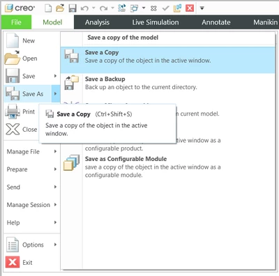

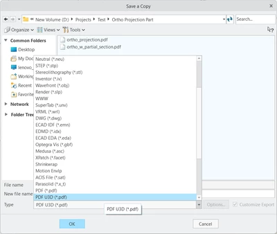

Save a copy of the assembly model as 3DPDF format. UI selections are shown below.

Creo supports export of 3D pdf file format. This format can be viewed in most modern browsers (with a plugin).
